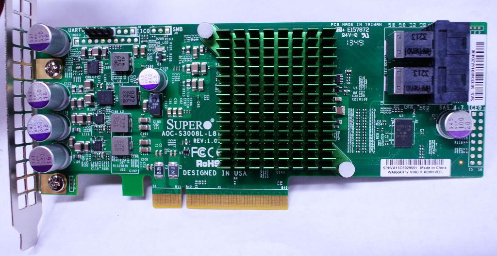

FWIW, I bought a 3008 card (thankfully for only $200) before I read up enough on ZFS and wanting access to each disk.
I did get it reflashed to IT mode and the 6 drives I have show up individually in debian. I got the firmware here from Supermicro's ftp site. Note that the first visit to the ftp site requires you to acknowledge / agree it's not their fault. Then you need to go back and hit the link again. It also may or may not popout.
Then I put the UEFI IT files on the same LMDE usb boot stick I used for installing the OS and booted to the UEFI: shell via bios boot menu. Didn't know that you need to use dos-like command to switch to the usb drive. btw, shift pg-up works for scrollback. The uefi script failed to flash, so I went back later and executed the same commands from the script one at a time and it flashed ok.
Also, since this is similar to the LSI 9300-8i, I went there and downloaded all the files. sas3ircu worked out of box in debian; I made that one file executable & copied to /usr/sbin Of note, the 9311-8i OEM version has better user documentation.

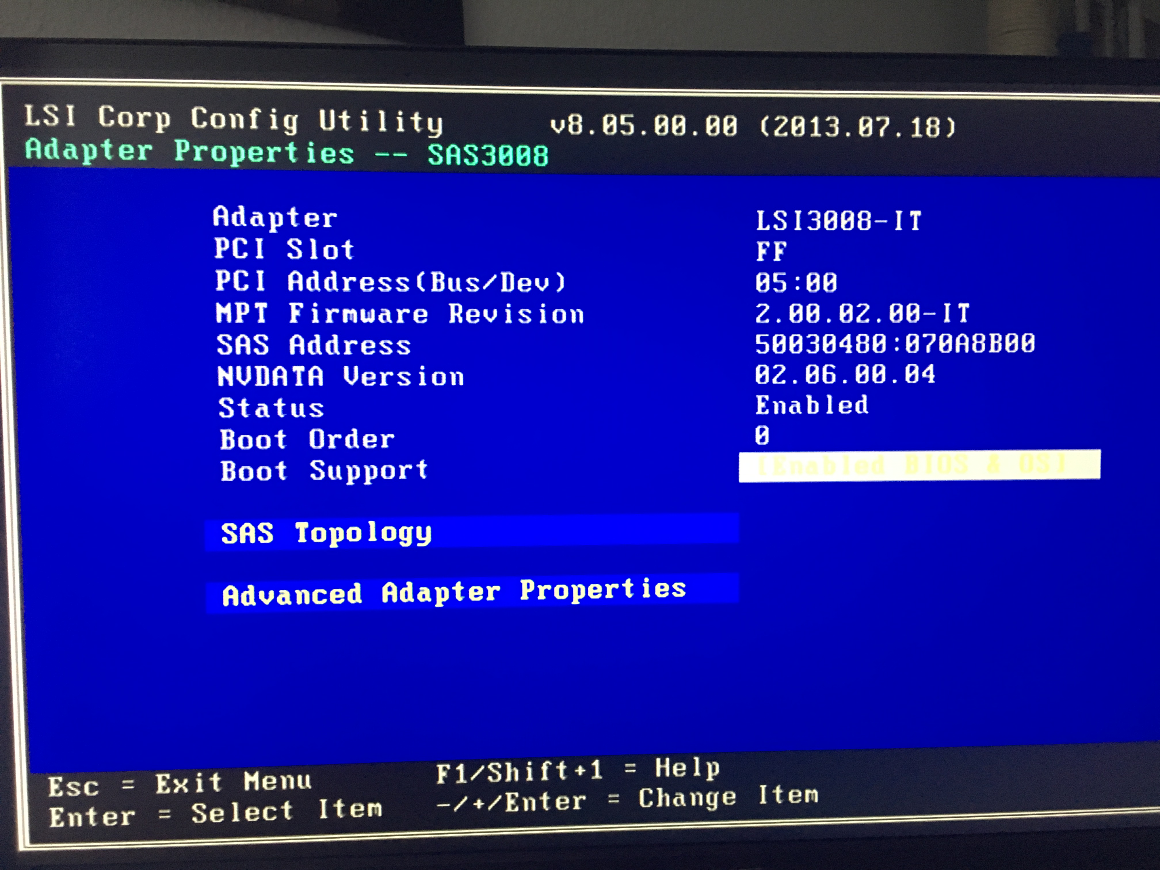

Hello,
I got the SAS3008 fixed, and it is now flashed in IT mode with the new BIOS.  PHEW!
When I boot it up, it shows all the drives, and I can go into the SAS BIOS and it shows everything now, as well as on the boot screen.
The problem I have is that in unRAID, the drives do not show up.  I pulled 5 drives and placed them on the mobo SATA ports, and those show up.
Do I need a driver for the LSI SAS 3008 to work, even if it is in IT mode?
Dave
Here is the IT BIOS:
www.davelikesbeer.com/lsi_it_mode_sas3008.zip
and if you want to go back to stock IR mode and make RAID0/2/10 array, like the way it shipped:
www.davelikesbeer.com/lsi_ir_mode_sas3008.zip
