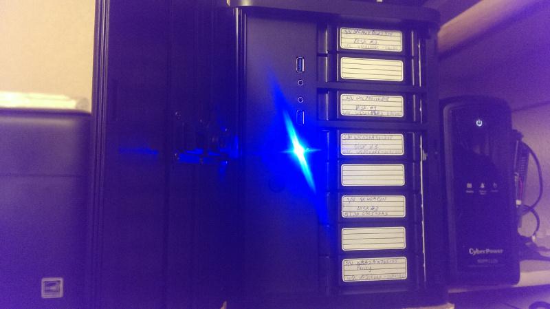

I have the case up and running. Amazing case, running 4x4tb and 2x2tb and the temperatures stay low and the case is really silent (i am controlling the case fan speeds manually). I also applied akasa sound absorbing mat inside the case.
Hdd cages also works like they should, easy to use and solid construction.
What i really like is the positive air pressure inside the case. With all the incoming air coming throught dust filter, there is no dust buildup inside the case...
