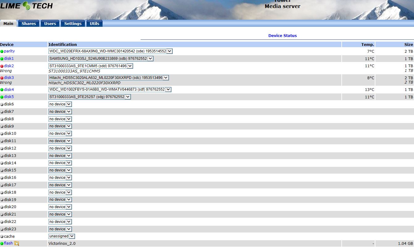

One issue though, on two of my 6 drives are saying "wrong".  Disk 2 and 3 in particular, the parity drive is okay.
At the bottom the array status says: Stopped. Two or more disks are wrong.
The two disks are correct with their serial numbers, so I'm not sure why it says its wrong.  I've attached a screenshot of it as well as my syslog.txt.  Any help you all can give me would be super appreciated!

Hi dgaschk, thanks for the quick response.
I did the hdparm commands and it did show an HPA.  I disabled it and rebooted my server.  Now, when doing hdparm -N /dev/sdc and sdd I see this:
root@Tower:~# hdparm -N /dev/sdc
/dev/sdc:
max sectors  = 3907029168/3907029168, HPA is disabled
root@Tower:~# hdparm -N /dev/sdd
/dev/sdd:
max sectors  = 1953525168/1953525168, HPA is disabled
root@Tower:~#
I checked my new syslog and I don't see anything regarding HPA...but my drives still say "wrong".  Any idea?

The disks need to be fixed one at a time using the last version of unRAID that they worked in. Revert the system to the older version. Undo the hdparm commands by running hdparm, setting the disks to the original size. All of the array disks must be green and the system must pass a parity check before proceeding. Once the array is green, run the hdparm command on 1 disk. Rebuild the disk and the run a parity check. Repeat with the other disk. Once the array is all green, and after the parity check, upgrade the system.
