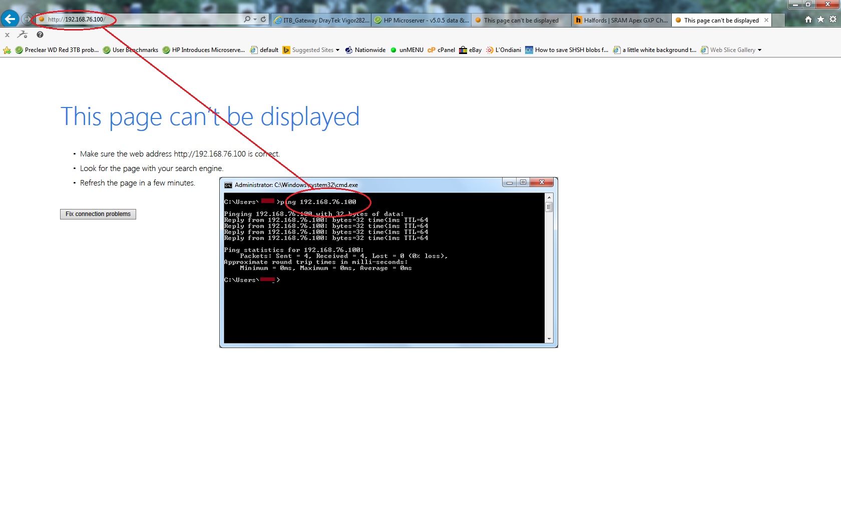

When I ping it - it returns <1ms with no losses, I cant connect to the UnRAID menu (http://192.168.76.100) but I CAN connect using UnMenu (http://192.168.76.100:8080)

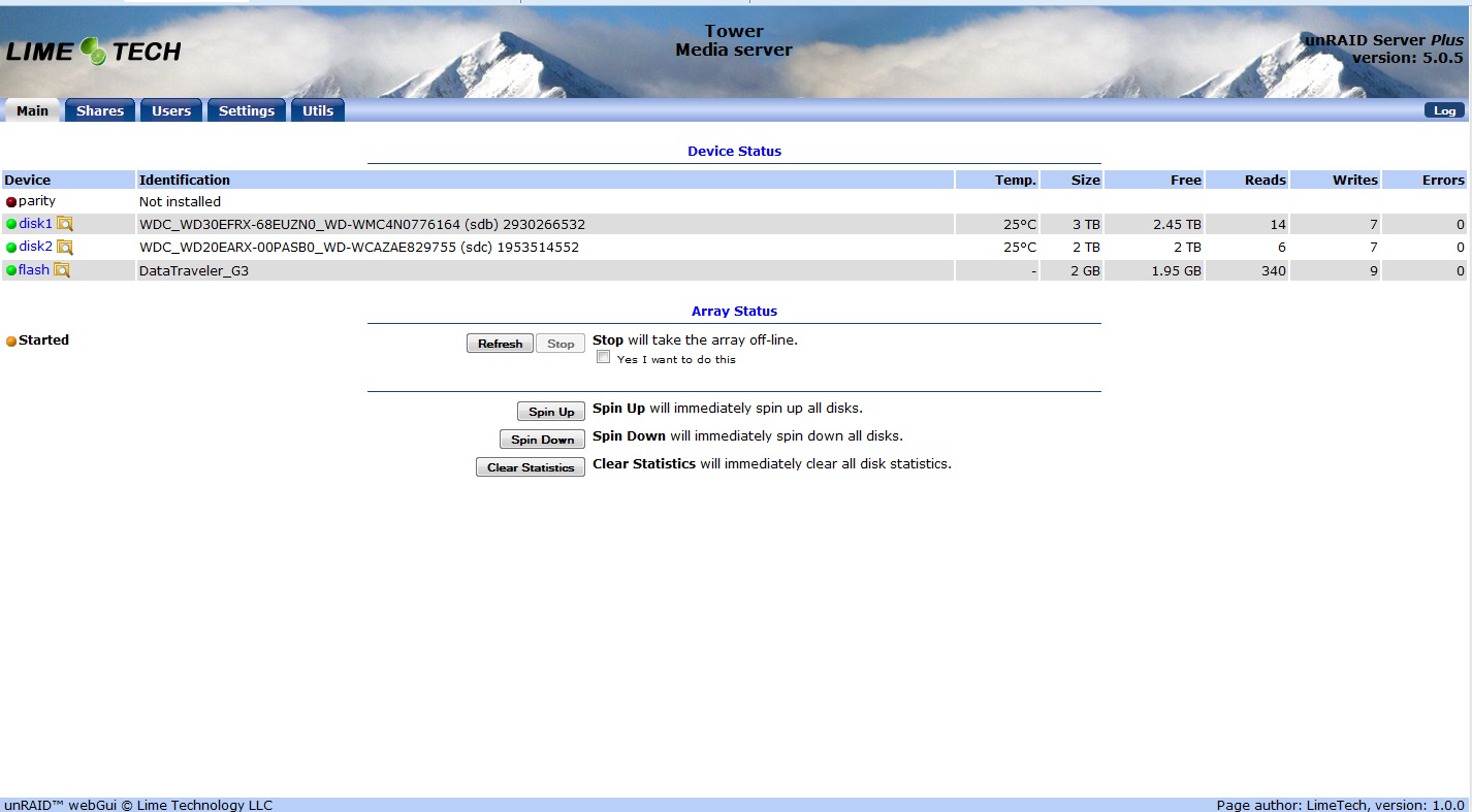

Hi dgaschk - sorry to disagree but I installed 5.0.5 and on the GUI it confirms this - have a look at the attached image.
If 6.3 is installed then there is an issue with the 5.0.5 install file I downloaded from the site?!?!
I also searched in the log file and there is a line which says...
Tower emhttp: unRAID System Management Utility version 5.0.5
My mistake. I must have been looking at the wrong log file. The WebGUI seems to be working now. What don't work?

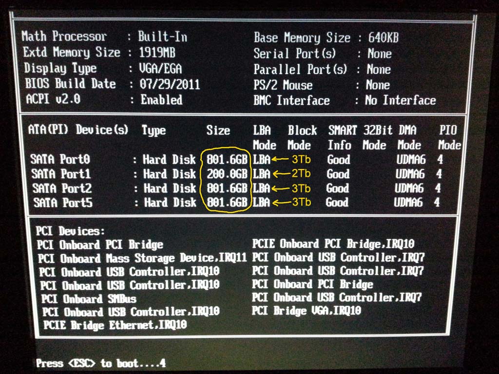

I don't know if this is related... but I have just noticed that the hard disk sizes are mis-reporting in BIOS... OK, this wont affect why I cant telnet or get the GUI, but I was wondering whether this might have bearing on the transfer failing?
Or, it might just be that the disks are so new that the BIOS cant understand it?
I have checked in the BIOS itself rather than the POST screen and it does correctly identify them as WDC WD30EFR and WDC WD20EAR's.
UnRAID does see them correctly as 2Tb & 3Tb disks  :) I am sure that someone once told me that as long as the OS correctly reports a HDD then it doesn't matter what the BIOS reports them as!
<See attached image>
As long an unRAID reports the correct size, don't worry about the BIOS numbers.

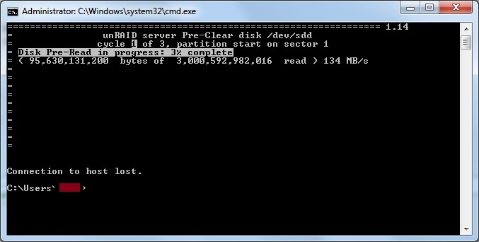

But my "losing connection" errors seems to be getting worse - I started to preclear my next 3Tb disk and got "Connection to host lost." <see attached>
However as I can still login in from the local machine I have generated a new syslog and attached it - just incase :)

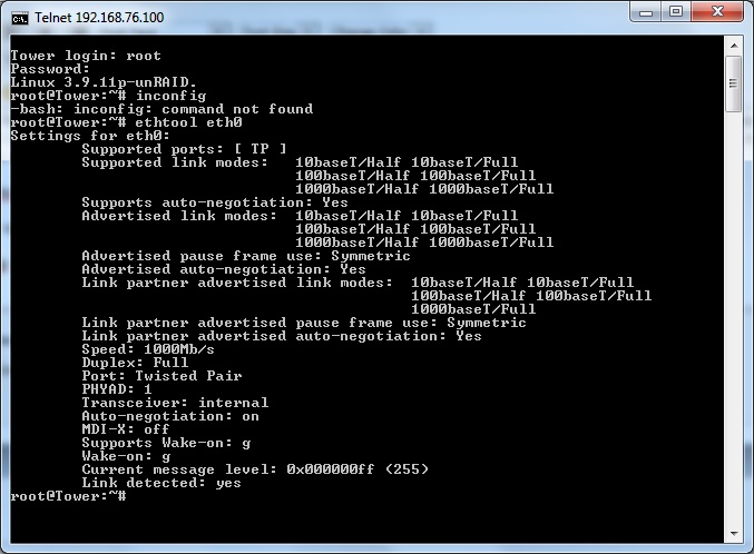

Paste the output of "inconfig" and "ethtool eth0".

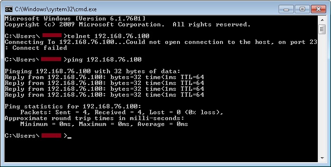

Tried to telnet in to run inconfig & ethtool eth0 and it says "Could not open connection to the host, on port 23: Connect failed"
From the local machine I can login OK, so I tried a second time using telnet and it let me log in...
inconfig = -bash: inconfig: command not found (do I need to CD to a folder?
see attached for full output.

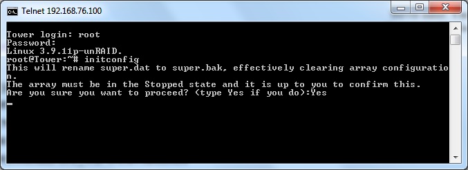

initconfig = This will rename super.dat to super.bak, effectively clearing array configuration. The array must be in the Stopped state and it is up to you to confirm this. Are you sure you want to proceed? (type Yes if you do): This
OK... decided to run with it - so I stopped the array, and ran initconfig - so far its been sitting there with a flashing cursor for half an hour - so I am not sure how long it takes to generate an output - but it looks like it isn't working :(
It normally runs in a fraction of a second!
Having said that I normally run this via the Utils tab of the GUI.
Thanks - the problem is that the server is unresponsive most of the time... if I ping the IP it responds <1ms, but as soon as I try to access the GUI it says page cannot be found and if I telnet in it says cant connect - it is as though ports 23 & 80 are blocked most of the time :( Really frustrating as I have been trying to get the unit online for 2 weeks and having bought 4 x 3Tb Red disks + another UnRAID key, I have invested enough to make it worth spending time on.

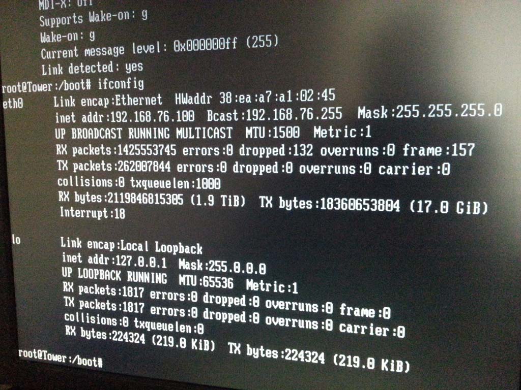

Can you attach a screen directly so that you have a console?  That would at least allow you to run the ifconfig command to see if the unRAID systems thinks it has an active network.  If it does then the failure to telnet n will be something external in your home network setup.  You should always be able to telnet in even if the GUI is being unresponsive.
Hi Yes, already have one on...
ifconfig result attached
I meant "ifconfig". I must have been tired. initconfig shouldn't hurt anything. You'll need to rebuild party or assign all disks and indicate that parity is good.
Sorry typo.
initconfig
Sorry typo.
initconfig
No problems - the parity drive is not built yet - just trying to get data moved... see post above your last for picture of ifconfig taken at local machine. Does show lots of dropped packets  :-\
Something else which may be relevant is that at the moment I still have no GUI access and when I telnet to the machine... it is working at the moment, but the time taken from pressing return after typing telnet to the login prompt is about 20 secs or so... whereas my other Unraid box comes up with a prompt instantly ?!?
