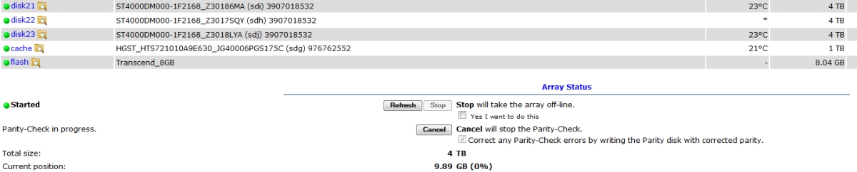

One thing is new to me...
Sometimes I dont get the temp. of a drive, there is an * instead.
...if I klick Refresh, i sonetimes get the temp and the * is on a other drive, or I'm lucky and get all Temps.
Any one any idea?
You will not the temp reported if the drive is spun down.
You have seen, that the Picture is showing an * and that a paritycheck ist running?
So no Drive is sleeping....
..and the * is hopping between the drives.....
