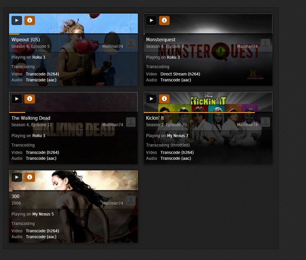

Sorry for all the questions but I am not very good at all this learning as I have been going. But here is a screen shot of my plex server playing several things on my home network. One Roku is not transcoding but 2 others are.

I have had this very same issue and it turned out to be because I was transcoding for audio. If your stereo, soundbar or television doesn't support the audio codec being received by roku via Plex it gets transcoded.
Example, my Vizio 60" TV does not support DTS audio, so despite the fact that it is optical cable from TV to sound bar, which does support it, causes plex to transcode it.
There is a log file in Plex you can tail and grep for the detail of transcoding taking place. A "1" means real time direct stream and anything slower is transcoded.
