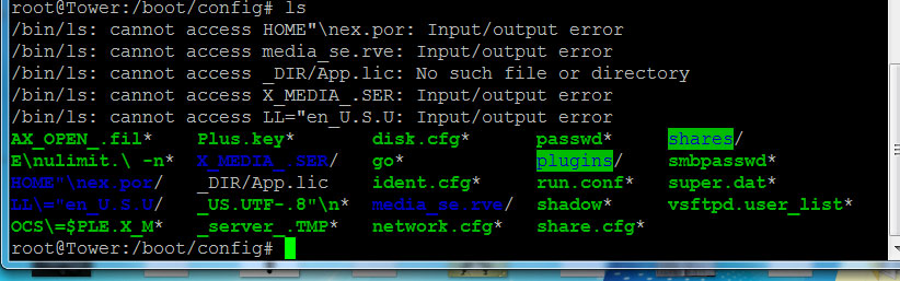

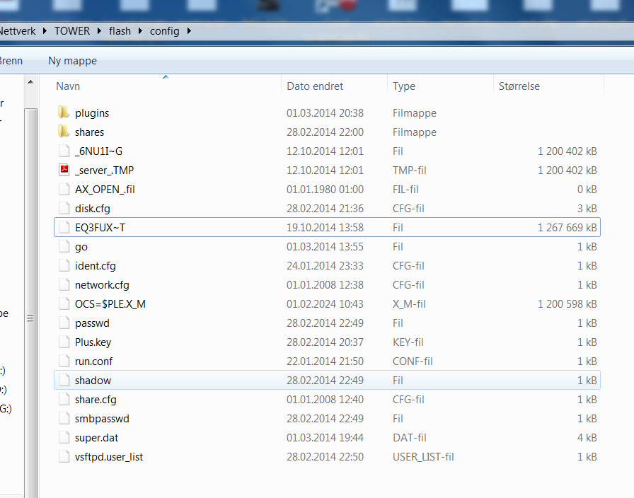

Looking into my USB drive, I find a few files I think is a bit strange. See picture. Looks like my Plex Media server is storing something there?
I tried to reboot my server, but same error. Is it normal that the flash/boot is write protected?
I tried again before starting the array, just after a reboot. Same thing..
Any idea?
Here is some error in terminal windows.

The strange files will not go away but they are not hurting anything. If you want you can delete
_6NU1I~G
_server_.TMP
AX_OPEN_.fil
EQ3FUX~T
OCS=$PLE.X_M

I can not delete any of the 5 "strange files"..

root@Tower:/boot/config# ls -al /boot/config
/bin/ls: cannot access /boot/config/. /boot/.con: No such file or directory
/bin/ls: cannot access /boot/config/HOME"\nex.por: Input/output error
/bin/ls: cannot access /boot/config/media_se.rve: Input/output error
/bin/ls: cannot access /boot/config/_DIR/App.lic: No such file or directory
/bin/ls: cannot access /boot/config/X_MEDIA_.SER: Input/output error
/bin/ls: cannot access /boot/config/LL="en_U.S.U: Input/output error
total 4870272
drwxrwxrwx  8 root root      65536 2014-02-24 00:16 ./
-???  ? ?    ?             ?                ? .\ /boot/.con
drwxrwxrwx 11 root root      16384 2014-02-24 00:16 ../
-r-xr-xr-x  1 root root          0 1980-01-01 01:00 AX_OPEN_.fil*
-rwxrwxrwx  1 root root 1298092613 2014-10-19 13:58 E\nulimit.\ -n*
d???  ? ?    ?             ?                ? HOME"\nex.por/
d???  ? ?    ?             ?                ? LL\="en_U.S.U/
-r-xr-xr-x  1 root root 1229411660 2024-02-01 10:43 OCS\=$PLE.X_M*
-rwxrwxrwx  1 root root        256 2014-02-28 20:37 Plus.key*
d???  ? ?    ?             ?                ? X_MEDIA_.SER/
-???  ? ?    ?             ?                ? _DIR/App.lic
-r-xr-xr-x  1 root root 1229210957 2014-10-12 12:01 _US.UTF-.8"\n*
-rwxrwxrwx  1 root root 1229210957 2014-10-12 12:01 _server_.TMP*
-rwxrwxrwx  1 root root       2204 2014-02-28 21:36 disk.cfg*
-rwxrwxrwx  1 root root        181 2014-03-01 22:41 go*
-rwxrwxrwx  1 root root        325 2014-01-24 23:33 ident.cfg*
d???  ? ?    ?             ?                ? media_se.rve/
-rwxrwxrwx  1 root root        223 2008-01-01 12:38 network.cfg*
-rwxrwxrwx  1 root root        889 2014-02-28 22:49 passwd*
drwxrwxrwx  6 root root      65536 2014-03-01 22:36 plugins/
-rwxrwxrwx  1 root root        592 2014-01-22 21:50 run.conf*
-rwxrwxrwx  1 root root        615 2014-02-28 22:49 shadow*
-rwxrwxrwx  1 root root        514 2008-01-01 12:40 share.cfg*
drwxrwxrwx  2 root root      65536 2014-02-28 22:00 shares/
-rwxrwxrwx  1 root root        209 2014-02-28 22:49 smbpasswd*
-rwxrwxrwx  1 root root       4096 2014-03-01 21:32 super.dat*
-rwxrwxrwx  1 root root          9 2014-02-28 22:50 vsftpd.user_list*
