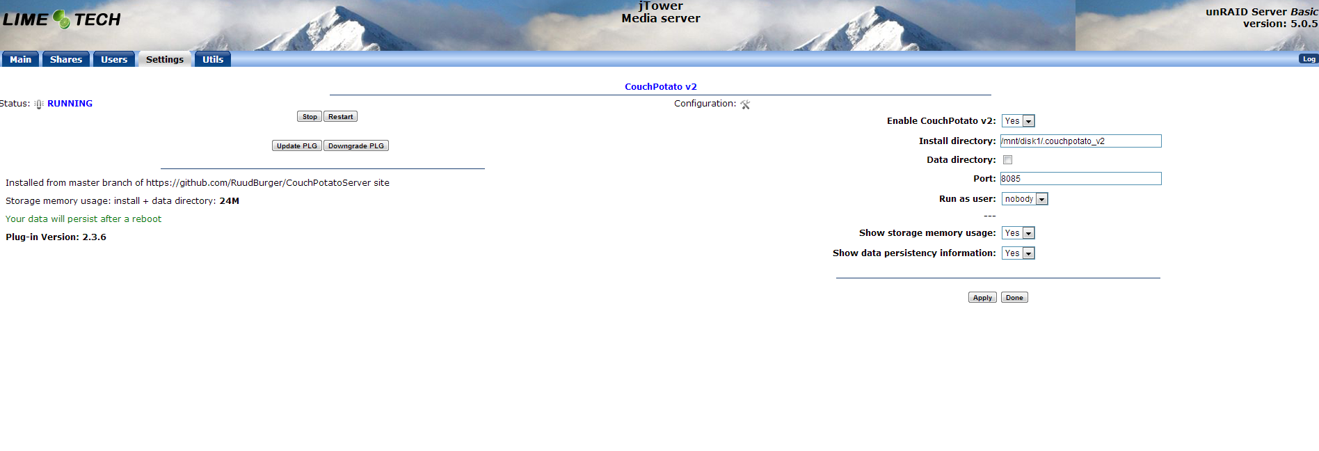

Please help, couchpotato inaccessible and not running. Screenshot attached
I can't access cp via 8085.
Please help

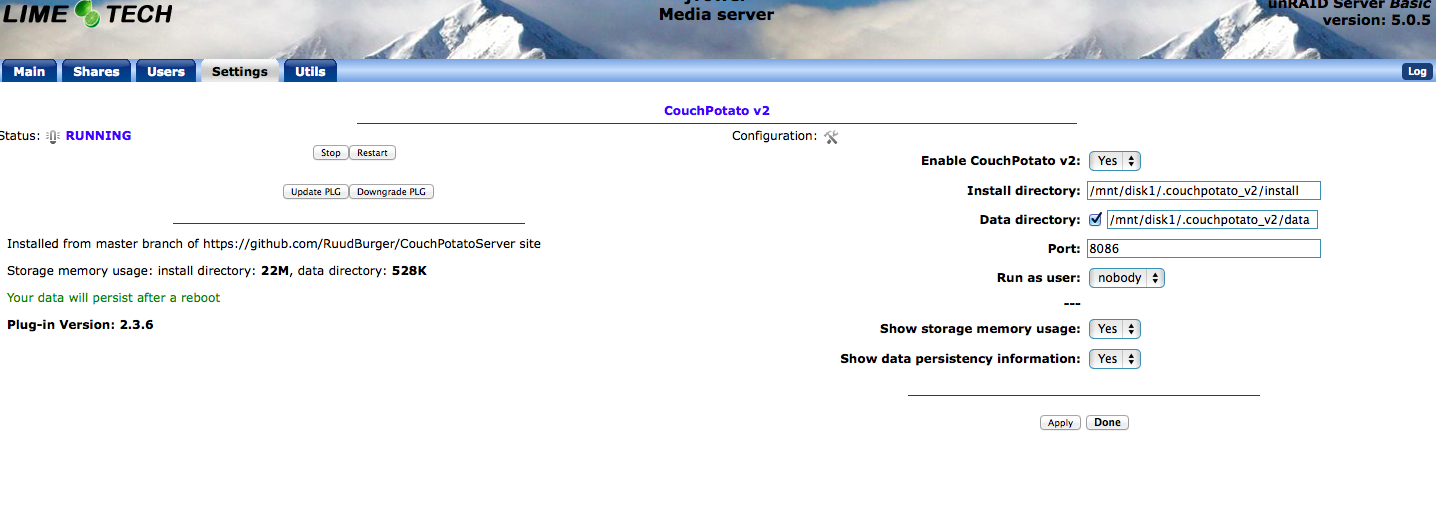

Try defining the data directory as well. You may need to start again with new directories.
Something like:  /mnt/disk1/.couchpotatoV2/install
And.                  /mnt/disk1/.couchpotatoV2/data
So to log in, it's something like 192.168.0.5:8085 where the ip is that of your unraid server. If that port doesn't work, try changing it to another, say 8005.
Failing all that post the log created by couchpotato in its install directory.
Hello Ockingshay,
I tried your advice, and it once again says installed.  Accessing it through the new port is still not accessible.  I copied a portion of logs from /mnt/disk1/.couchpotato_v2/logs/CouchPotato.log and here it is:
