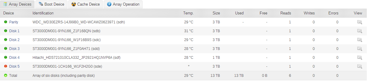

Thanks for the quick reply lionelhutz. I will try to get all of this information and pictures tomorrow night. I need to go to bed. I updated my above post with a screenshot. I turned it back on just to see what drives show up.

This appears to be sde, Disk 5, attached to the fifth motherboard SATA port.  This looks like a connection shook loose, and again the SATA link stayed up, but the drive was not responsive, and was disabled too.  Essentially the same suspects...
