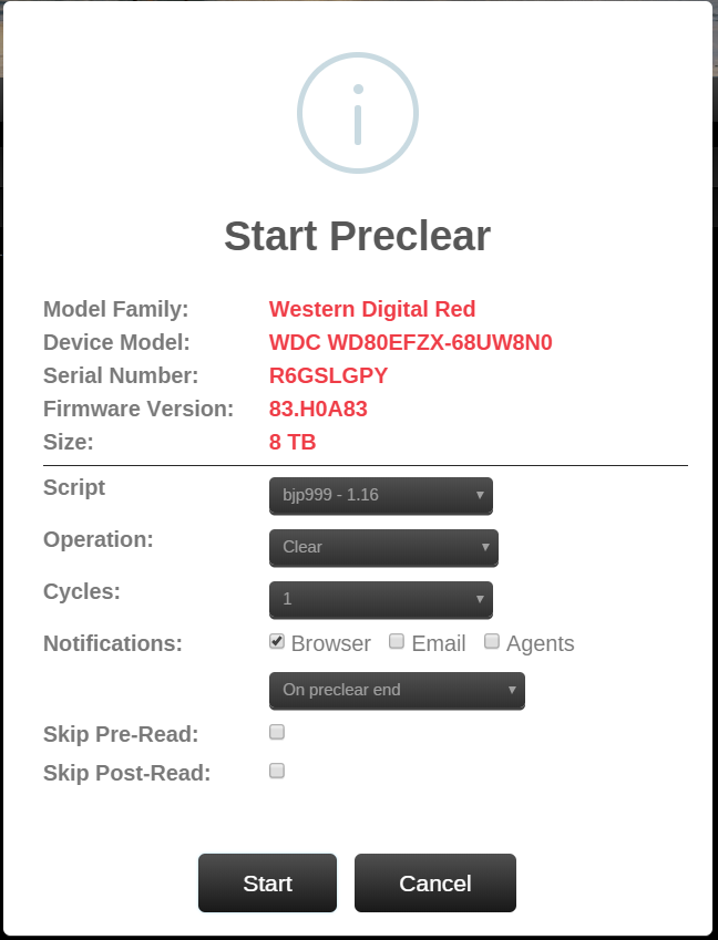

BTW, I tried to start preclearing a second disk and noticed that I do not get the option for faster post-read (as this post mentions):
Edited by papnikol
3 minutes ago, papnikol said:
BTW, I tried to start preclearing a second disk and noticed that I do not get the option for faster post-read:
So the script has been fixed to work with unraid 6.5.1, however this does not mean its compatible with the unraid preclear plugin, thus you may get issues with the plugin, thats why i recommend switching to gfjardim's plugin and script once he has fixed it up.
got it, I will try it from shell. Just FYI, I noticed that the option is not available with the unpatched faster preclear script too.
