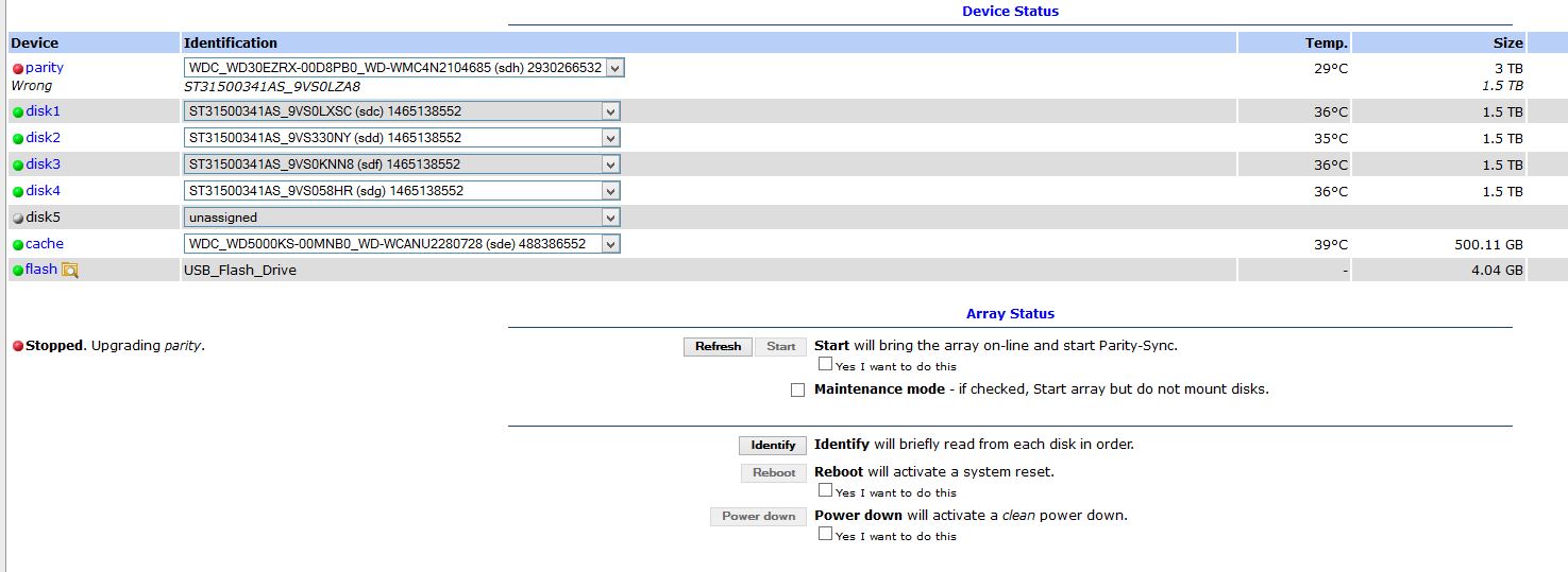

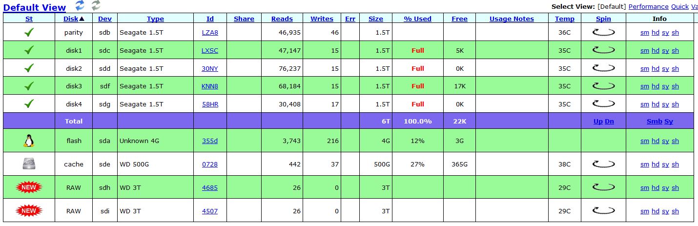

Ok, here you go.
As you can see,
1) 2 new 3TB drives are recognized
2) my existing drives are all 1.5 TB in size
3) my parity drive is 1.5 TB which will not be allowed when I include new 3TB drives since it won't be the largest
4) my cache drive is faster 500GB drive
When I stop my array, it only offers to add a 5th drive (apart from the parity and the cache drives). Is Unraid limited to 5 drives?
How do I add 2 new 3TB drives?
How do trade places between my actual 1.5 TB parity drive and a new 3TB drive?
Then how do I make the former 1.5 TB parity drive a part of the array, along with the remaining 3TB drive?

While I am waiting for my new license to arrive I replaced my 1.5TB parity drive with a 3TB drive but the array won't start.
It says "Stopped. Upgrading parity"
The message seems appropriate but nothing else seems to happen.
I don't know if it is really doing it.
And I cannot start the array, not even the Maintenance mode.
Any means of checking what is going on?

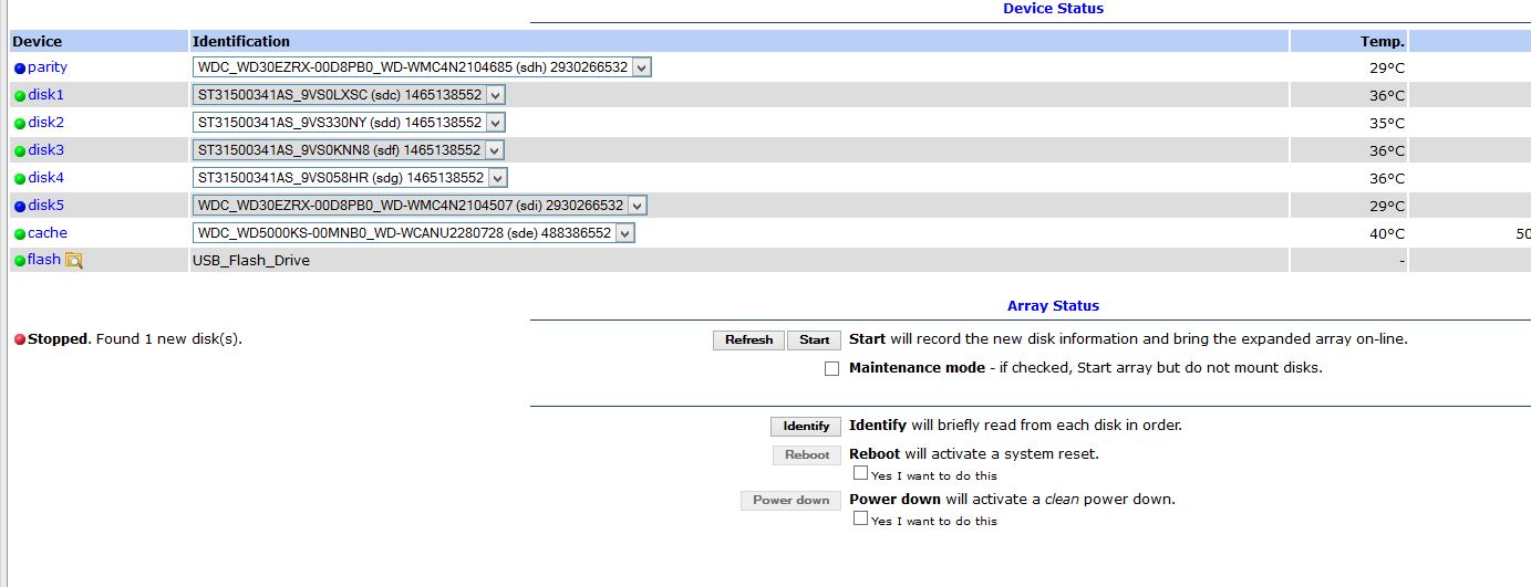

I played with the GUI a bit and got into this new situation (see attached screenshot).
But that doesn't help since i cannot start the array.
Running the 'top' command shows that the whole system is idle.
Is that normal?

That's right. When my old 1.5TB drive is parity then all drives are green, parity checks ok, and 0 errors.
