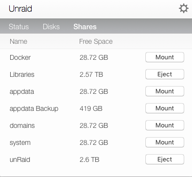

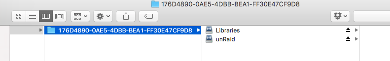

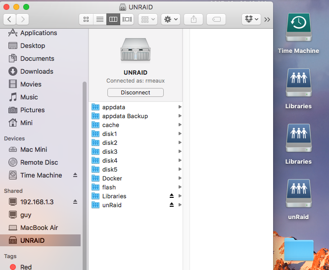

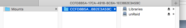

I have an unrelated/related situation I need your input on.
As you know I have used the script forever and switched to Sierra and Margarita mounting. I have 2 shares I mount on all devices, "Libraries" and "unRaid". Since I had that stale mount issue we discussed earlier, my "Libraries" share has been double/duplicate mounting. It was also that share that was stale.
Things I have done and checked:
- deleted all script files and folders
- used AppCleaner to remove Margarita and reinstalled (all files, folders, and nz.co.pixeleyes files)
- I am only exporting SMB
I do not think it is Margarita doing it, I just need some direction on where I can look to see what is mounting it. It's almost like "Finder/Connect To Server" is remembering to do it itself. I have attached screenshots of mounts and Margarita's container folder you directed me to last time.
Thanks ahead, any input greatly appreciated.
If you go into /Applications/Utilities and open Terminal.app, then simply type: 'mount' and show me the output?
Cheers
Says mounted by Mini, that is the name of this Mac Mini
Last login: Sat Oct 15 18:32:04 on console
Mac-Mini:~ Mini$ mount
/dev/disk1 on / (hfs, local, journaled)
devfs on /dev (devfs, local, nobrowse)
map -hosts on /net (autofs, nosuid, automounted, nobrowse)
map auto_home on /home (autofs, automounted, nobrowse)
/dev/disk2s2 on /Volumes/Time Machine (hfs, local, nodev, nosuid, journaled)
//[email protected]/Libraries on /Volumes/Libraries (smbfs, nodev, nosuid, mounted by Mini)
Mac-Mini:~ Mini$
OK - there is something else mounting your share. AutoMounter has no access to /Volumes due to SandBoxing limitations (also co-incidentally fixes a few issues regarding Sierra bugs).

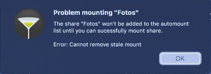

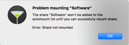

I upgraded to Sierra from Mavericks over the weekend. I am trying to get Margarita to auto mount some unraid shares and run into this error -- see screenshot. After dismissing this dialog, the share does mount, but upon reboot, it does not automount.  I'm sure I'm missing something simple.
