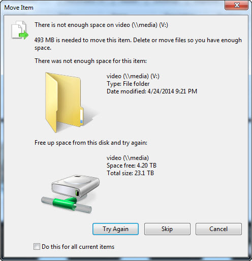

I've been getting some weird errors with this beta version when trying to rename some files.  the error message is copied below, along with a syslog.
I suspect I've got some permissions problems, so I'm going to run the new permissions script, but I thought I'd read that it's not recommended once you're already running version 5 or higher, which I have been since I first installed unRAID.
I'm using the XEN version, and have an arch VM running, along with SABnzbd and SickBeard; but I thought they were isolated from unRAID, so I'm still not sure what's going on.
When this error happens, I lose all control of any file system activity in any program and my laptop is basically useless until it's done trying to rename the files, which takes 5-10 minutes.
A few quick thoughts (without looking at the syslog):
As you know, a 'rename' is a form of 'move', which normally identifies that the source location is the same as the destination location so just modifies the file entry with the new name.  If however there is a problem determining the locations are identical, then a physical move is started, copy all then delete from source.  This obviously takes much longer, which makes it correspond with the long delay you are seeing.  I don't have any ideas as to why it would mistake the source and dest locations here though.  The fact that it indicates it needs 493MB to make the move does seem to indicate a true physical move, not a rename.
Since the share 'media' appears to be 23TB, it must be spread across multiple disks, so the free space of 4.2TB is the sum of free spaces.  It looks like it is trying to move to a destination with much less space, either another array drive within the Share or the Cache drive.  Check those for enough space.  And remember that new file operations on a ReiserFS drive that is almost full are very inefficient, very slow.
No real answers here, but I hope this may point you in the right direction.

Those are good points.  Now that you mention it, most of my drives are VERY full.  4 discs have 0KB available, 4 have under 300KB available, and the other 2 are newly added, and are the only real source of available space.
Device	Temp.	Size	Used	Free	Errors
Parity	33 °C	4 TB	-	-	0
Disk 1	35 °C	3 TB	3 TB	16.4 KB	0
Disk 2	36 °C	3 TB	3 TB	291 KB	0
Disk 3	33 °C	3 TB	3 TB	0 B	0
Disk 4	33 °C	2 TB	2 TB	4.10 KB	0
Disk 5	32 °C	3 TB	3 TB	0 B	0
Disk 6	22 °C	1 TB	1 TB	0 B	799
Disk 7	21 °C	1 TB	204 GB	796 GB	0
Disk 8	30 °C	3 TB	3 TB	49.2 KB	0
Disk 9	32 °C	2 TB	2 TB	0 B	0
Disk 10	29 °C	4 TB	529 GB	3.47 TB	0
I'm currently running a parity check due to having to hard-boot the machine, but when that finishes, I'll move a few hundred gigs off all the full drives, and see if that helps.
With that said, I really do feel like this is a bug with unRAID.  If it's trying to 'move' or 'rename' a file onto the same disk, but it's full, it should know to use another disk with free space.  I have no grouping setup, so there is no reason to not use the available space instead of giving me errors.
Either way, I appreciate the response, and think moving some files around should resolve this issue.
Thanks again.

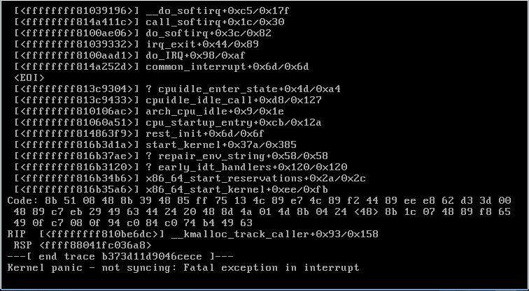

I'm not sure whether to post here or in the Xen area.
My unRAID server suddenly became unreachable through the network.
I'm running 6.0-beta4 on the hardware detailed in my .sig.  I'm running three virtual machines - two of IronicBadger's ArchVM pre-rolled images, and another running WinXP.  This XP machine was installed new yesterday.
One of the ArchVM machines is running a number of services - MySQL (MariaDB), Deluged, minidlna, LogitechMediaServer.
Dom0 is running a few plugins: apcupsd, tftp-hpa, fan_speed, dovecot and mpop.
The other two VMs are virtually dormant.  I did have a vnc connection open to the WinXP machine.  The second ArchVM has xfce loaded with tigervnc server - there were no connections to this.
I have been running beta4 for more than two weeks, and the first ArchVM for almost as long.  tftp-hpa has been running for more than a week -  and the other plugins have been running since day 1 with beta4, and for many months on v5.0.
I did have ssh sessions open to Dom0 and the two ArchVMs.
There was an XBMC media server playing a video from a user share.
I was playing with the Dom0, via ssh, trying to enable the session name to appear in the title bar of my Gnome terminal.
All of a sudden, everything stopped - XBMC stopped playing, my Squeezeboxen blanked, my deluge transfers froze etc.  I was unable to access any shares from my Ubuntu desktop, and all the ssh sessions froze.  I couldn't get a response from the Tower emhttp interface.  Tower would respond to pings, but not any of the VMs.
I went to ipmi and was able to capture the attached screen image.  I was aware that fan-speed was still active because I could hear the fans speeding up - the drives must have been getting warm(er).
I didn't have the presence of mind to attempt any interaction via ipmi!  :-[
I did a soft reset from ipmi and everything came back up as normal, with a parity check running.
Does anyone have any idea what may have caused this?

When I try to access a share remotely, while it appears as accessible, it gives me an error when I try to access the share.
The log is attached as a PDF.
I hope this helps.
In the meantime, I'll disable mover and the cache drive and wait for some fix or the next beta.
Your syslog piece seems to clearly show that the General Protection faults occurred because of the mover, with the first occurring only 10 seconds after starting.  Initially, the rsync module was corrupted, then later nmbd (part of SMB, which is part of your network access to your shares) was corrupted.  I still believe memory is a suspect (test it overnight), but could also be an incompatible library somewhere (wait for a later release), or a hardware fault (hmmm...), or a BIOS fault (check for a BIOS update).
Just a request, we always prefer syslogs as complete as possible, and in their original text state, unmodified in any way.  A pdf was fine for this short piece, but simple text files are easier for me to compare with similar syslogs.
I hope this helps.

Yes you're right, i meant adding a drive and letting unRAID clear it. I've not tried using the preclear script
Cant post a log now, could do later today but here is a quick screenshot i took this morning http://i.imgur.com/rLcZRyd.jpg
4GB ram and no addons
I would suggest you get your array back up without the new disk. Then use the preclear script on the new drive. Maybe not related to your problem, but it is a safe way to make sure your new disk is good enough to put into your array.
Thanks.
I tried the preclear script but it is failing in the 2nd step with Kernel Panic - not syncing:Fatal exception in interrupt Error. I have created a new thread for this. http://lime-technology.com/forum/index.php?topic=33105.0
