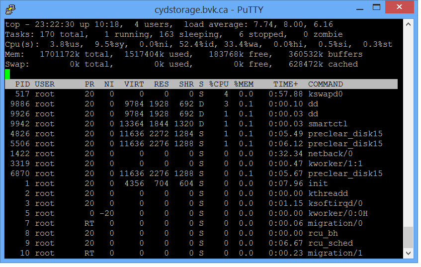

I am having this issue again as we speak. I've included my syslog, but it's not reporting anything. I have both IE & Firefox spinning away trying to load the main page of UnRAID. All my shares are available, and I have a couple of pre-clears running in screen at the moment, but CPU usage appears low (though memory usage is fairly high - top image is included as well).
I am not sure what else to try here.
Any suggestions?
syslog.txt
As SueprW2 figured out you may need to remove everything from your plugins folder including the WebGUI folder and reboot. Let us know
I cleared out the WebGUI folder, but will have to wait for the preclears to complete before I can reboot. I will post the results when I can.

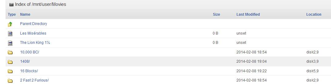

The share browser doesn't seem to handle unicode characters in the directory names. Clicking on the link returned a 403 Forbidden error.
This is fixed in next release.
