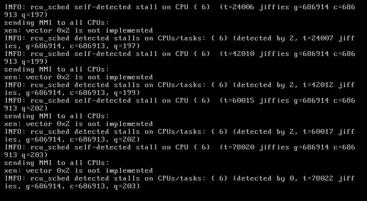

I'm not sure whether to post here or in the Xen area.
My unRAID server suddenly became unreachable through the network.
I'm running 6.0-beta4 on the hardware detailed in my .sig.  I'm running three virtual machines - two of IronicBadger's ArchVM pre-rolled images, and another running WinXP.  This XP machine was installed new yesterday.
One of the ArchVM machines is running a number of services - MySQL (MariaDB), Deluged, minidlna, LogitechMediaServer.
Dom0 is running a few plugins: apcupsd, tftp-hpa, fan_speed, dovecot and mpop.
The other two VMs are virtually dormant.  I did have a vnc connection open to the WinXP machine.  The second ArchVM has xfce loaded with tigervnc server - there were no connections to this.
I have been running beta4 for more than two weeks, and the first ArchVM for almost as long.  tftp-hpa has been running for more than a week -  and the other plugins have been running since day 1 with beta4, and for many months on v5.0.
I did have ssh sessions open to Dom0 and the two ArchVMs.
There was an XBMC media server playing a video from a user share.
I was playing with the Dom0, via ssh, trying to enable the session name to appear in the title bar of my Gnome terminal.
All of a sudden, everything stopped - XBMC stopped playing, my Squeezeboxen blanked, my deluge transfers froze etc.  I was unable to access any shares from my Ubuntu desktop, and all the ssh sessions froze.  I couldn't get a response from the Tower emhttp interface.  Tower would respond to pings, but not any of the VMs.
I went to ipmi and was able to capture the attached screen image.  I was aware that fan-speed was still active because I could hear the fans speeding up - the drives must have been getting warm(er).
I didn't have the presence of mind to attempt any interaction via ipmi!  :-[
I did a soft reset from ipmi and everything came back up as normal, with a parity check running.
Does anyone have any idea what may have caused this?

I had the same issue, posted a thread about it but got no feedback. Like binhex had to do a hard reset but got no logs. Remains a mystery.
Did you have the dhcp delay workaround in place by any chance too?
I too had the same problem, couldn't get logs because it had totally frozen.
The "xen: vector 0x2 is not implemented" line is what I remember from the console.
Had to hard reset to get it back running.
I thought maybe it was overheating (being in a closet), so I moved it to a corner in my living room and blew some compressed air to clean the vents and fans.
Since then, no moore freezes/hangups...
Had no issues with version 4 and 5 for a couple of years.
Come to think of it, I did. What I'm not positive on was whether I had just switched to Tom's method or not.
No issues since then for me too. The only diff since then is that I haven't booted up my Win7Pro VM as I forgot my license key was OEM based...but that's a separate issue.
