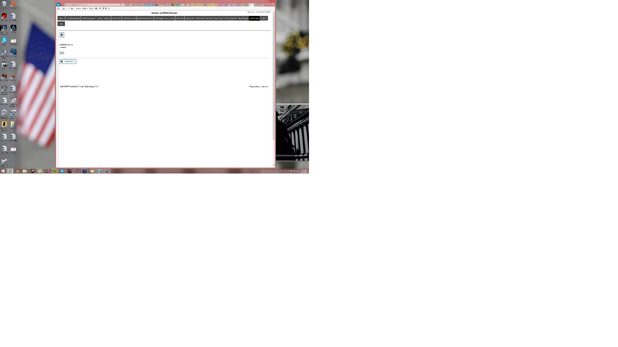

So I have not posted in awhile (years?) because with the help of you guys my unraid server has been running beautifully! My issues started after upgrading from version 4 to the newest version 5.05.
When I go to tower:8080 It opens unmenu and looks fine.
When I click on the tab "Unraid menu" the image does not show up properly and I get something like the second picture.
Also when on the array management tab by the start array button there is a message that says "Unfortunately, it is not possible to start the unRAID array in the unMENU interface. Please use the "Start" button on the Lime-Technology supplied management web-page to restart "
I can not figure out where the supplied management web-page is beside the unraid menu that is not working.
Thanks!

You also say "I get something like the second picture". Did you intend to post a first picture because I only see one?
What do you get if you just go directly to http://tower or http://192.168.1.16
It never really worked after upgrading. I meant just the picture that I uploaded. And it looks exactly the same if I go to either http://tower or http://192.168.1.16. I do remember that it actually worked One time after the upgrade but I can not figure out why.

I started in safe mode and still have the same issue. It looks like the attached picture.

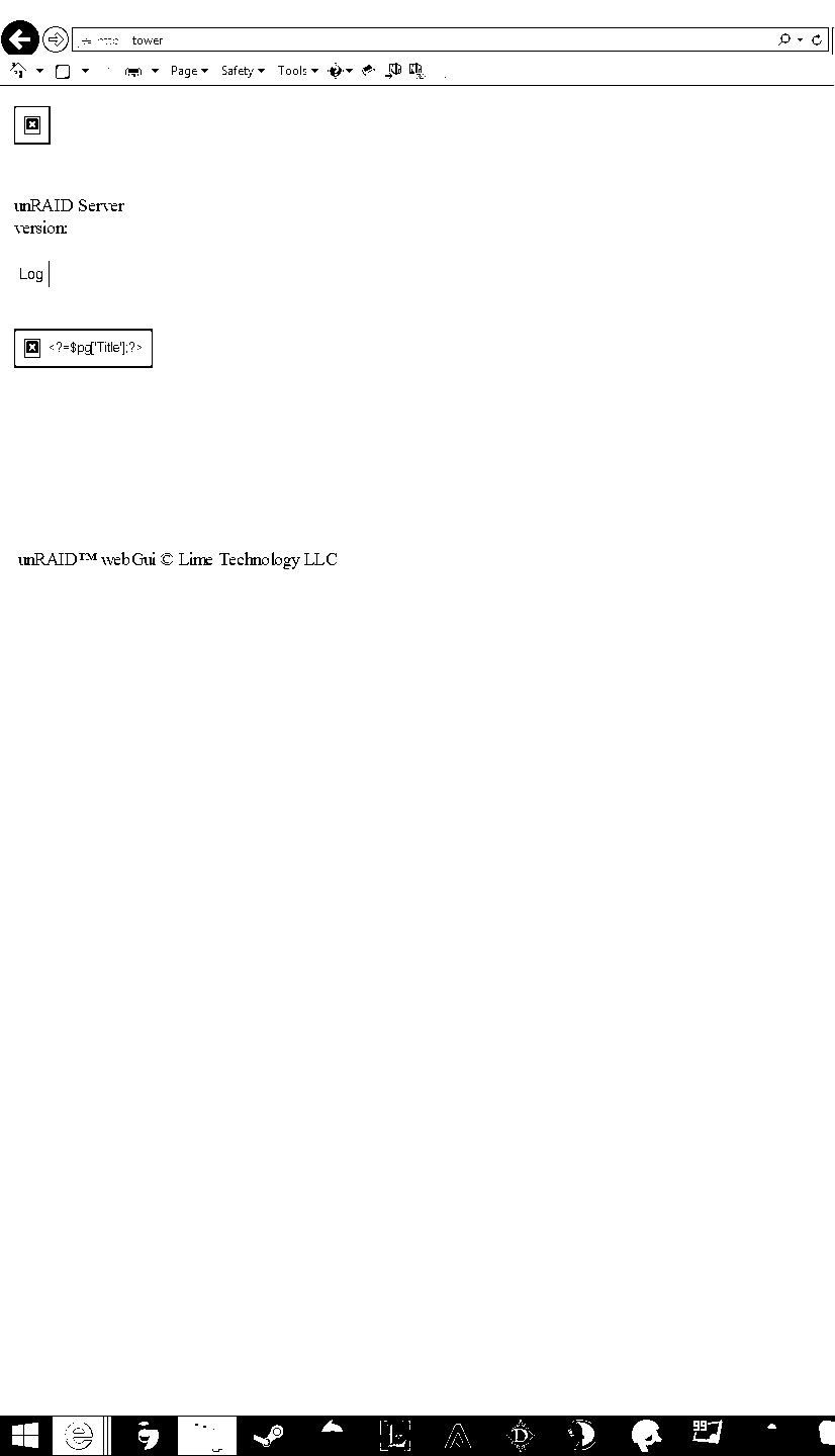

Here is what it looks like from just tower:80

OK guys so I think I fixed part of it (for now).
I backed up my flash and then changed the Go file to the stock one so unmenu is not active.
That worked and I can access the main GUI and start the array.
