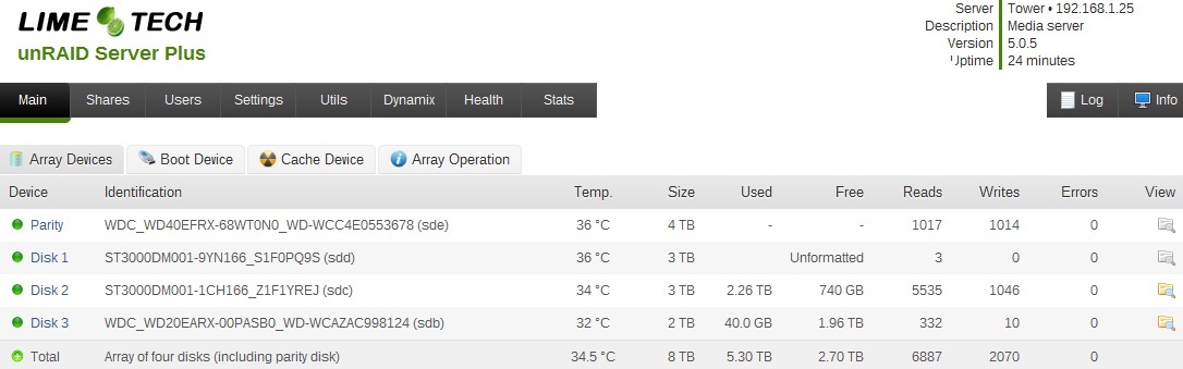

I am using V 5.05 and this is what I have now. It was working good for around three months.
Parity  WDC_WD40EFRX-68WT0N0_WD-WCC4E0553678
Disk 1  ST3000DM001-9YN166_S1F0PQ9S
Disk 2  ST3000DM001-1CH166_Z1F1YREJ
Disk 3  WDC_WD20EARX-00PASB0_WD-WCAZAC998124
And a cache drive.
I rebooted unraid and had a big chaos…..IF you read this post you will see.
[ftp=ftp://lime-technology.com/forum/index.php?topic=32808.0]http://lime-technology.com/forum/index.php?topic=32808.0[/ftp]
The problem is that unraid thought that Disk 1 (ST3000DM001-9YN166_S1F0PQ9S) was my parity drive and started to do a parity…..apparently writing on disk one. I stopped the parity right away….one minute or so into it.
As of now Disk 1 appears as unformatted and I am missing a lot of files. I would say that all what was on disk 1 is lost.
I ran reiserfsck --check /dev/md1 and got:
Failed to open the filesystem
If the partition table has not been changed, and the partition is
valid  and  it really  contains  a reiserfs  partition,  then the
superblock  is corrupted and you need to run this utility with
--rebuild-sb.
IF I run a parity check without disk1…would I get the files back?
Shall I format disk1, add it to the array and do parity?
Shall I do -- rebuild-sb?
I need advice because I wouldn’t like to lose all the data.
See pics and syslog from this morning attached
Thank you

One more pic. another minute of parity with the unformatted disk
You do have a mess on your hand. Looks like you have done something to make parity valid after screwing up your disk 1. Hopefully you did not you run a parity check (=parity-rebuild)?
If you did, that rebuild your parity to reflect the corrupted state of disk1 and effectively destroyed your good parity that you would have been able to use to rebuild disk 1. You will have to look at recovering files from disk1. Sorry, no clue how to do that. I bet you wish you had stopped and asked for help as soon as you realized you had corrupted disk1.
Hopefully, parity is only showing as valid because you forced it with console commands. Sorry, I'm not going to read your 3-page thread. If that is the case, you should be able to simply stop the array, unassign disk1, start the array (which will then invalidate the data on the physical disk1, since you may be making changes to the virtual disk1 that is now available via parity), then stop the array, the reassign the now invalid disk1, and start array. This should start rebuilding your disk1 from good data and you will rejoice with much happiness.

Array started, It shows disk 1 with red dot.....Not Installed...I guess as it should.
Files are still gone.
Should I run a NO-CORRECTING parity check as suggested by Morten?
You can't. That was a step got before. Are you sure the filed are gone? What is at /mnt/disk1?

Does it still say the disk is unformatted?
Take a GUI shot.

Are you sure that all of the disks are in the array the way they were before this fiasco?
Take a GUI shot.
See attachments

Yeah, I just looked at the screenshot again and see disk 1 shows up as both "not installed" and "unformatted". However, nothing in his description of events explain why the simulated disk1 would be corrupted/unformatted. First I thought disk1 was not being simulated, are we 100% sure it is in fact being simulated here?
It may very well be BJP is correct, that restoring the disk config will not help, but on the other hand it is hard to see how it would do any harm (assuming you physically unplug disk1 so the array doesn't start automatically when you boot).
