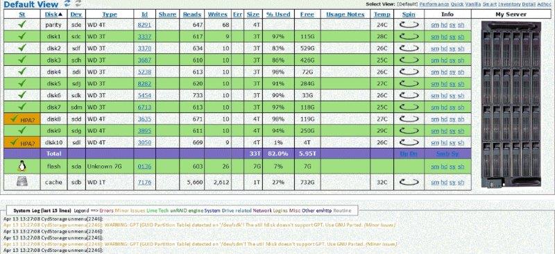

I just installed UnMENU/myMain to get more information on my unRAID server, and after setting this up I am getting some messages in unMain that I wanted clarity on.
I recently precleared several 4TB drives, some using JoeL's script and some using BJP's updated script. 2 of my 4TB drives report a potential HBA issue (as shown in the picture). I dont' know if these tie into the ones I cleared a specific way (i.e. BJP's revised post-clear) or not. I am sure the disk10 was done with the updated script, but not sure about disk8.
I am also seeing messages about GPT Warning. It is suggesting using GNU Parted. Is this something I need to worry about? Do I need to empty these disks to fix this issue?
I don't know if it's worth posting a syslog or not. I've started with just the myMain screen shot but can add the syslog if recommended.

myMain has a list of common sizes of normal commercial disks. It compares the size of the disk with that size with one of those values. If it doesn't find an exact match it suspects that the motherboard may have installed an HPA on the disk. HPAs are not the end of the world, but for a number of reasons motherboards that add HPAs to disks can be dangerous to your array.
As disks get bigger we have had to add entries to the list of normal sizes. The most current new entry is for 4T drives, and the value is 3,907,018,532.
Just above the drive table, to the right side, there is a prompt that says "Select View". Click on the view called "Detail." Find the 4T drive in the list that that is reporting an possible HPA issue, and look at the value in the "Size (k)" column. Tell me what number you see there. It should match the value above.
I have also noticed the "GPT warning" message. It is not causing any harm. Need to investigate that further.

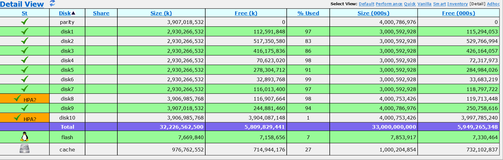

I've attached the detail screenshot, but the two disks in question are showing 3,906,985,768.
Should I be re-formatting these drives?
Interesting.  Re-formatting won't change the size of the disk if you have an HPA issue.  You'll need to use a tool like HDAT2 (works very well) or follow the procedure that's been outlined elsewhere in the forum using Linux tools to fix it.
Note that there's NO issue just using the drives are they are, except you lose a tiny bit of space (32,764 bytes to be precise) that you likely wouldn't have ever used anyway (How many 4TB drives are filled to within the last 32Kbytes ??).    The only negative thing is you could not re-assign either of these drives as the parity drive.

I am a little out of my area of expertise here. May need Joe L. But notice that disks 8 and 10 exhibit this issue, but disk 9 (same size disk) does not.
I would suggest you run the "fdisk -l /dev/sdX" where /dev/sdX is you disk's device designator (e.g., /dev/sdz) on each of the three drives. You can find the device info on the "default view" of myMain OR by doing the configuration change below to the detail view. Once you've run these 3 command, post the results.

Gary - I'm thinking this has nothing to do with a motherboard added HPA, but that this is a byproduct or remnant of the preclear issue faced earlier.
... An afterthought:  Have either of these drives ever been installed in a different PC ??  If these are new drives that you've simply added to UnRAID on this PC it seems you MAY have found a bug in the pre-clear revisions bjp made.  Did you pre-clear these with the 32-bit or 64-bit implementation?

I think I can live without the missing space, but am curious on the cause of this. One of the drive is basically empty so I can fix it, move the data from the other 4TB and then fix that one, but since I use the same process on each drive I don't understand how this issue arose.
I am assuming this process will wipe out the partition, which is fine, but will I need to re-clear the disk before it's reused? Or will UnRAID want to clear it itself again (basically hanging the GUI/Array for 10 hours)?

No, I've never used them outside of unRAID, and the pre-clear would have all been done on the 64-bit version.
I just went back through the preclear reports and one was done using BJP's script, and one was using v13 of JoeL's script.
What is interesting though is the two disks in question were both taken from external WD My Book enclosures. They are the only ones I've had like this (the other were purchased as internal disks). Not sure if that matters in the least, but is an interesting coincidence at a minimum.
Actually, if you use HDAT2 to do it -- and I assume the same thing is true with the Linux commands, but I'm not a "Linux guy" so I can't say for sure -- it will simply change the reported size of the disk to the correct value.  The current partition structure won't change ... you'll just have some unallocated space after it.    What impact this will have in Linux I don't know.  If it was a Windows drive, nothing would change at all ... there'd just be some unallocated space after the partition unless you subsequently used a partition tool to expand the partition.
I'm curious as to whether this is actually an HPA issue, or if the revised pre-clear has simply not used all of the drive's space for the partition it created.    Since bjp is both the author of MyMain and also made the pre-clear revisions, he can answer that  :)
In any case, if the drive is subsequently reported with a different size, I suspect UnRAID will indeed treat it as a new/different drive.    I don't know for certain, but I suspect the end result will be that it wants to rebuild the drive ... which should work fine PROVIDED you only change ONE of the drives at a time -- and then wait for the rebuild to complete.    From UnRAID's perspective, it'll be as if you changed to a larger drive ... but if you change both at once it'll think there are TWO new drives, which, of course, is an error UnRAID can't protect against, so it won't be able to rebuild either one.
BINGO !!  Certainly NOT a "coincidence."    I think you've just identified the issue ... they almost certainly have an HPA (probably has something to do with WD's SES system on these drives ... but the reason is irrelevant).
I think you've just "cleared" the changes to pre-clear as being just fine  :)
So ... up to you whether you want to "fix" the issue, or just leave them as they are.    The ONLY "problem" this creates is the warning in MyMain for those drives.
... and bjp's customization options would, I believe, let you set these drives to ignore that warning -- so you wouldn't see it anymore either unless you revert to the "Default" view.  He outlined this in his last post ... I'm sure if you need detailed help in doing it he'll be glad to oblige if you ask  8)

Although I made a few changes to the preclear script, it was only to add some logging so myMain could see the status and speed up the post read verify. I made no functional changes to how the partitions are created or how the preclear signature if applied. I am as ignorant as you about how this part of preclear works.
myMain has an easy way to suppress the HPA warning.
If you set the "hpa_ok" attribute to 1 on the drive settings page, you can turn off that HPA warning.  Just click on the drive's ID in the ID column (last few letters of the SN).  The drive settings dialog will open.  Find the "Other Notes" field. Below it should be a number of blank rows where you can enter custom attributes. (There probably aren't any defined yet, but you might have some if you had override values for any smart issues). Find the fist blank row and enter hpa_ok in the first entry field, and 1 in the value field (see below for a screenshot). Click Save (very important). The HPA warning will go away for that drive.
Obviously these disks would be poor candidates for parity disks, because the size would be just shy of the size needed to protect a 4T drive without the HPA. I don't think there are any other issues, but not 100% sure if the alignment would have been altered. I doubt it.

Clearly I'd suggest you add those fields in MyMain so you don't see the warning.    Other than that, I wouldn't bother to change anything.  As I noted before, the ONLY issue with those drives is that they can't be assigned as your parity drive ... but by the time your current 4TB parity drive needs replaced, you'll likely be doing it with a 5TB or 6TB drive anyway  8)
... the HPA has no bearing on the alignment of the partition you're using.
