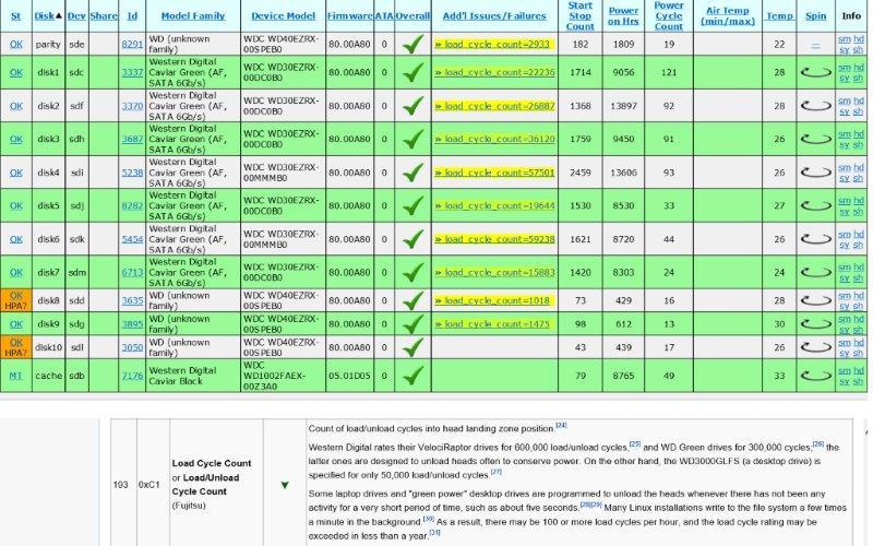

I have a question about the Smart View of myMain.
As you will see in the screenshot each of my drives shows a warning about load cycle count, even though the description from Wikipedia (which is also captured in the screenshot) indicates that WD Green drives should be good for 300,000, whereas my "warnings" range from 1000-60000.
I am confused why these are popping up as warnings given the low values. Is there something I am missing?
Your values aren't "low" => they're well below the thresholds for the drives, but that's quite a few load cycles for drives with such a relatively low number of power-on hours.
You have a couple of choices ...
(a)  Don't worry about it.  You can set MyMain to ignore the values & it won't show you the warnings anymore.  bjp has outlined how to do this already.
(b)  Change the behavior of the drives so the won't unload the heads so frequently.  How to do that is outlined here:
http://www.storagereview.com/how_to_stop_excessive_load_cycles_on_the_western_digital_2tb_caviar_green_wd20ears_with_wdidle3
Load cycle counts (LCCs) are sort of an odd attribute. The logic that myMain uses, is that if the LCCs are larger than the powered on hours, or if they are larger than some fixed number (5000 I think), then the warning will show up.
When I programmed myMain, there was (and still is) debate on whether the LCCs are really a problem or not. It was my goal to let people know that the LCCs are piling up early. because as you probably know, there is a way to make the drives not do them nearly as often. Giving the warning early gives user a reason to research the issue and slow them down sooner rather than later. If you haven't already, suggest you look into ways to slow down the LCCs.
So no doubt you now know about LCCs. :) What you might not know is it is easy to set your own limit of when to be reminded again.
All you have to do is click on one of the yellow warning message (e.g., click on the "load_cycle_count=2933"). It will open the disk configuraiton screen and set an optional attribute called "load_cycle_count_ok" to the current value (e.g., 2933). With this setting an LCC of 2933 or lower on this drive would be ignored. The problem is the LCCs will continue to increase, and you don't want the message to reappear when it goes up to 2934, which is exactly what would happen. What you need to do is set the value to something higher. 10000, 100000, 250000. Whatever you want. Make sure to hit the save button after setting the value. The LCCs will silently increase and there will be no warning on the screen until it hits that level UNLESS you use the "RAW" refresh (see the 2nd two refresh buttons).
So if you work yourself down the list and update the number on each drive to something considerably higher than the current value, then all of the warnings will be cleared for some time to come.
BTW, this technique works with any reported SMART attribute. Unless it is something bad and I intend to replace the drive, I will do this whenever I see a warning. That way I know when I come back that an attribute has gotten worse.

I think I would like to fix the disks rather than just hide the warning as I would rather extend the life of the disks, but I have them all in a Norco 4224 case, so plugging in one at a time is a challenge. I may need to setup another system and just take each disk out, fix it, and reinstall.
Your instructions did make sense though. Just after reading the article Gary posted it seems like something I don't necessarily want to bandaid over.
You need to do both. The procedure won't decrease the LCCs, just make them not grow as fast. You'll still want to hide the yellow warnings. You can just set them up to remind you when they reach a certain level (maybe 2000 higher than the current value). That should keep you a while after you do the procedure.
