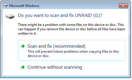

I connected the flash drive to my win 7 install on parallels. It immediately warned me that some files may me fixed with a scan (first image in attachments)

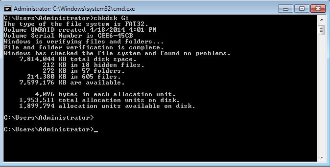

Then i ran chkdsk on the drive (second image in attachments)
