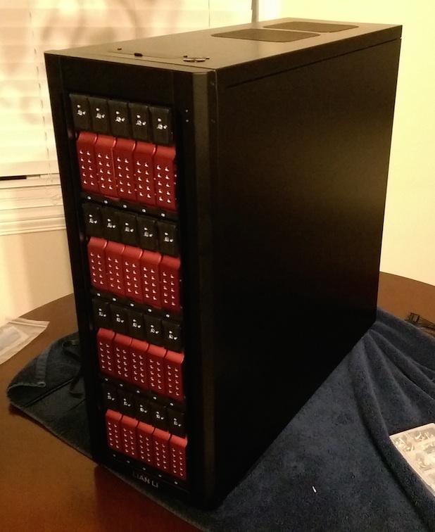

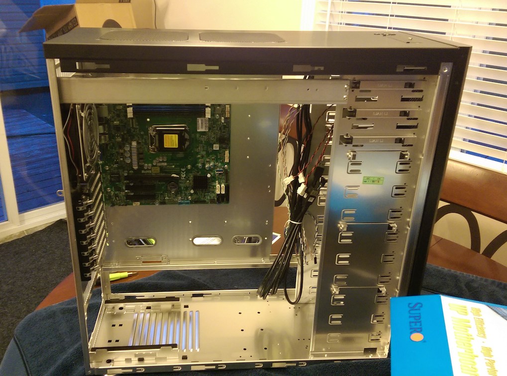

The case is very Big!  I didn't remember how big was a Full ATX Tower !!
I started by removing the Lian-Li Internal Drive cage (they were nice, with a big fan), but inconvenient for hot-swaping drive in a Unraid server and I wanted the Red Look from my Drive cages :P
After that, I added the motherboard (Supermicro X10SLL-F-O), then the PSU.
I also connected most of the Power/Reset/HDD LED/Power LED on the right pins headers of the board.  I choose to not connect any of the top connectors because I won't use them (server will go in a Colo datacenter).  What's good about this motherboard is that it get a Internal USB connector, I'll connect a Sandisk Cruzer 16GB (the recommended model from Lime-Tech) the USB key right inside the case.

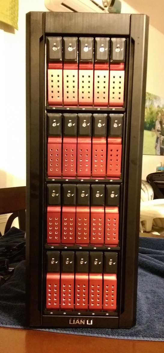

I then removed all the 5.25in blank and started to install all my 5in3 drive cage.  I did put 5 brand new WD RED 3Tb in the 5 first bay.
I finished by installing the CPU and Heatsink (Xeon E3-1240v3 + stock Intel Fan).
Issues

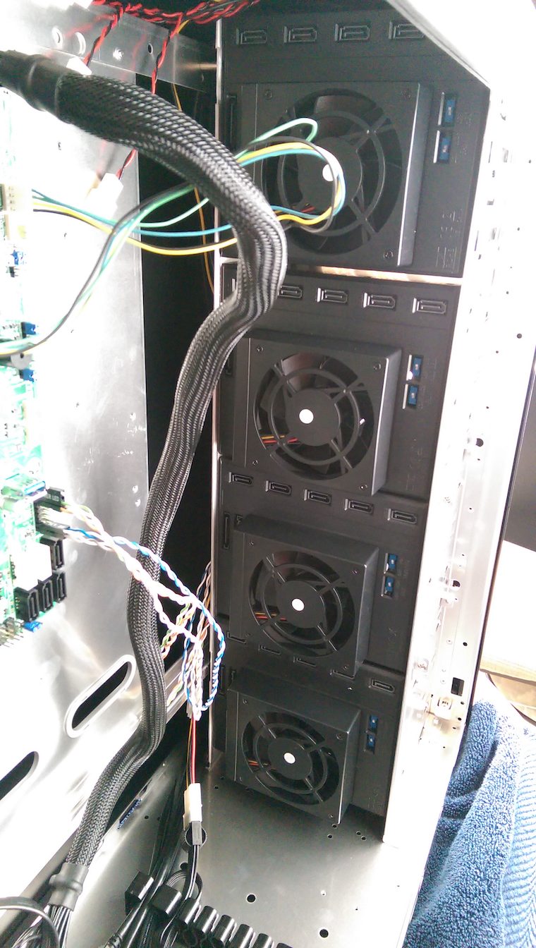

My first issue was with the Drive cage #1 (the top one).  The Lian-Li first 3 x 5.25in bay had some metal "L" shape bracket to hold CD-ROM drives.  I just pried them and I was then able to add my drive cage #1.

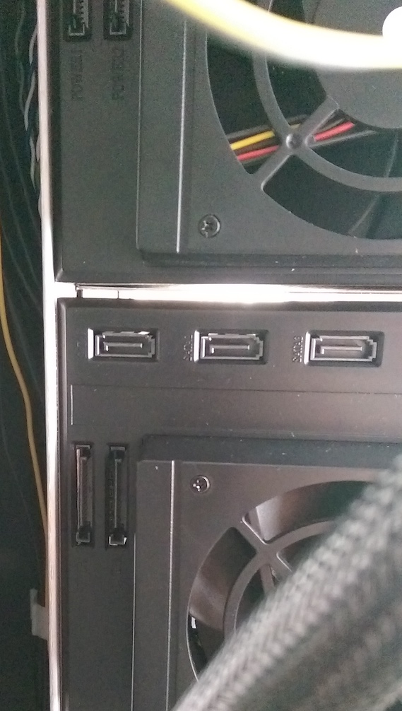

I'm having some issues with SATA power connection.  I choosed the Seasonic X-Series 850W PSU (fully modular) and my drive cage (5in3) are the iSTAR-USA.  my issue is that the power connectors are too close from each other on the iSTAR-USA 5in3 and because the SATA power cables from my Seasonic are too short.  Also, the connectors on the drive cages are not in the right orientation... I think i'll have to go buy some good quality cable and create my own custom power cable (with the connector that goes in the modular PSU of the Seasonic).
See next reply to this posts for pictures
And the last picture.  The Motherboard look so tiny in that BIG Full tower ATX!
It's coming along, thanks for posting the update. Yes, it will work out better to have custom PS cables for the cages. I've seen connectors available, but I haven't looked for cable. I imagine you can get that locally at a hardware store. Could you post a picture of the back of the cages as stacked up inside the case?
i'll take some pictures tonight, in about 1 hour, but I finally ordered some "Y" Sata power adapter.  I'll use more than 1 rail (even if I would have enough) just to spread the load.  I know that Seasonic says 70A for 12v rail (1 rail only), but the PSU still have 3 or 4 Modular connectors for the 12v rails.
This is the one I ordered :
http://www.monoprice.com/Product?c_id=102&cp_id=10226&cs_id=1022604&p_id=5184&seq=1&format=2
They should work great because they are not "L" shapped, but strait connectors, that should help with the 2 Connectors on each 5in3 cage being too close from each other.
And a close up on the Power Connectors.  They are on the left and close to each other + close to the fan side...
Thanks for the photos! So, it looks like the orientation of the iStar cages doesn't matter and they give you mounting holes for both mounting styles.
