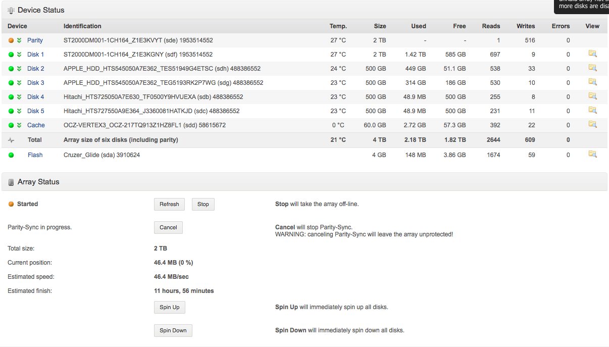

Well guys, I did it. I posted a screen shot from right after hitting start.
I turned on Caffeine. I am not gonna refresh the browser for as long as I can even though I think I can at this point.
I will post the results after it finishes. I can see disk 2 says 449GB used so thats a good sign.
Again, Thanks for all of your help. Some of you are pure genius. I love unRaid and this community. I leaned a lot in the past years setting up and maintaining this array.
I hope I don't need any more help. Will post the results, good or bad, whatever they may be.

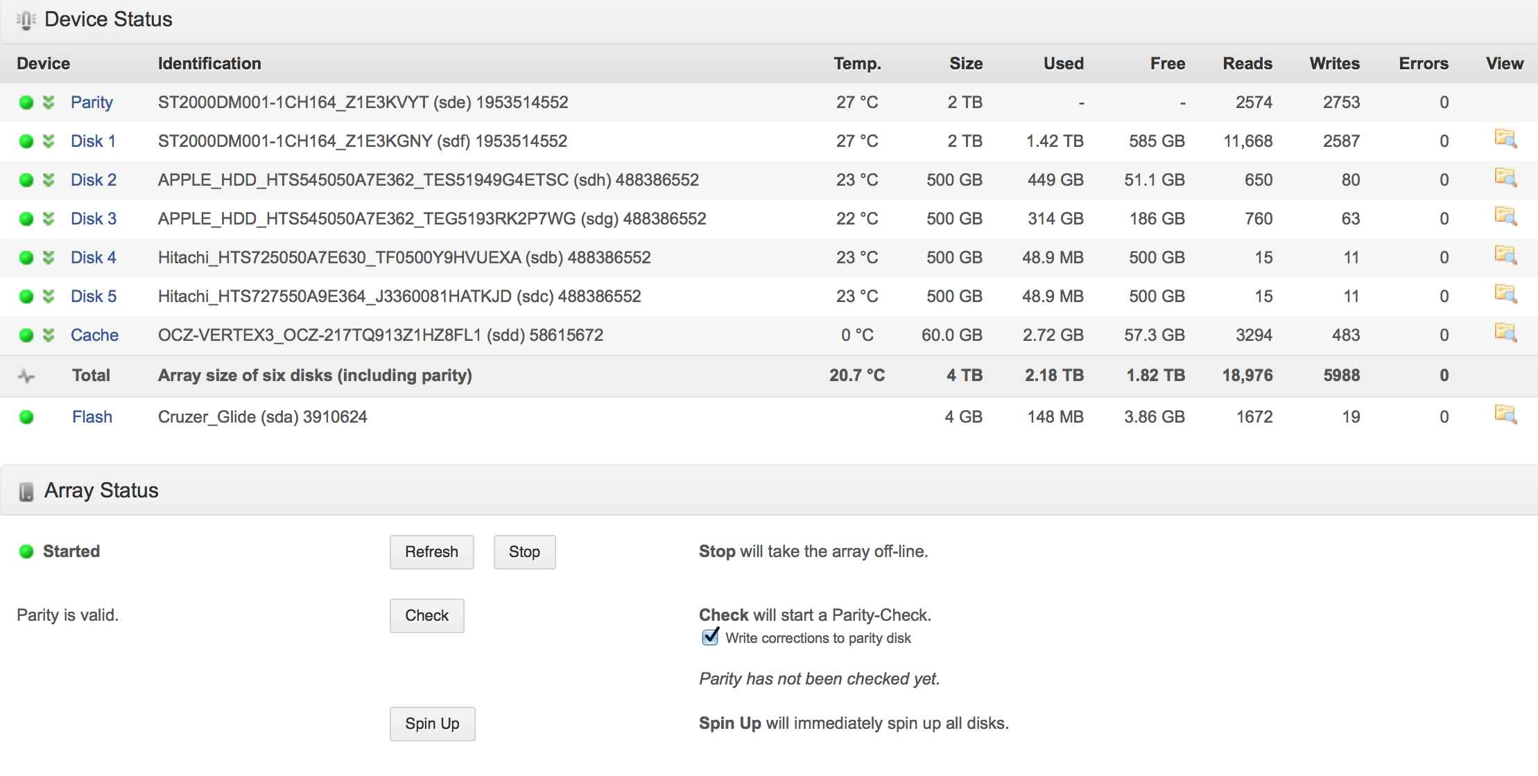

What a beautiful Picture (attached GUI Screen Shot)
I can't thank this community enough. Everything looks OK so far.
Small corruption on my iPhoto Library but no big deal.
