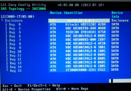

When I boot it up, it shows all the drives, and I can go into the SAS BIOS and it shows everything now, as well as on the boot screen.

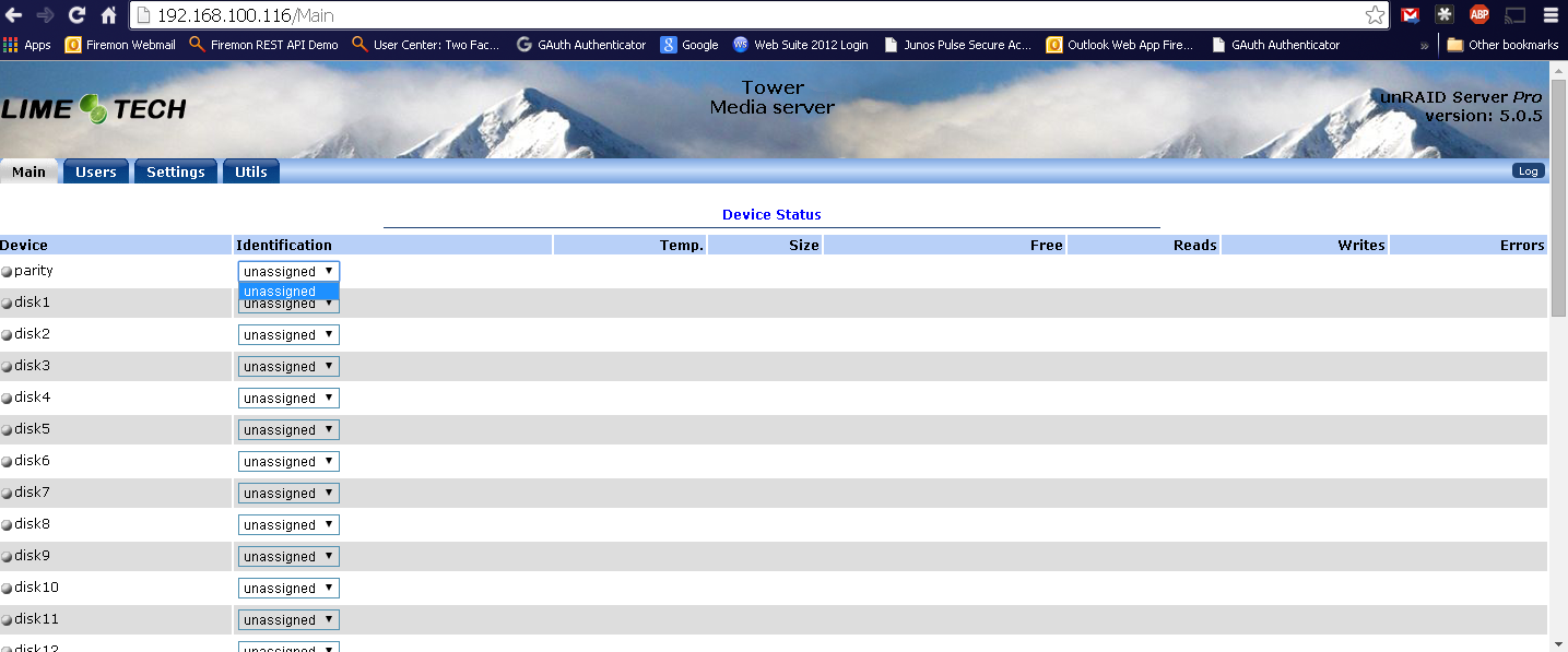

The problem I have is that in unRAID, the drives do not show up.  I pulled 5 drives and placed them on the mobo SATA ports, and those show up.

However, I can only see the drives in unRAID if I plug them into the mobo SATA, and not when I plug them into the LSI SAS3008.

When I go to the drives and click the drop down, nothing shows, this is my problem.  If I plug the drives into the mobo STA ports, I can see them, but not when plugged into the LSI SAS 3008.  I have 13 drives, so I need to make use to the SAS 3008, mobo only has 6 ports.

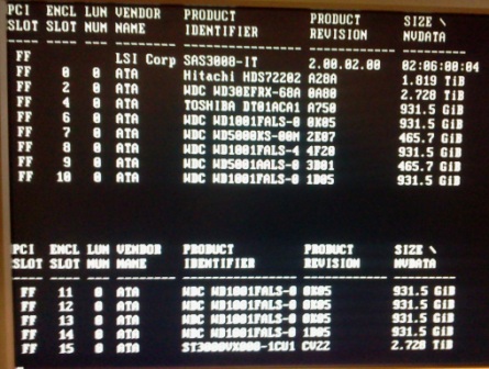

Here are pics of the RAID controller and booting the mobo and that it sees the drives.
