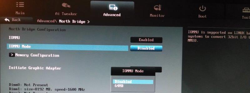

OK So I've sent this directly to Tom as well but i wanted to get the masses involved too.
I used to be running the system shown below in my signature with no troubles at all.  then I tried upgrading my hardware to Asus M5A97 R2.0 / FX-8320 / Kingston 8GB ECC and all hell broke loose.  In order:
- First thing I noticed was that bzroot was loading VERY slowly.  I played around with the BIOS looking for any thing that might be driving it to USB1.1 but nothing helped.  I did let it boot though and there were still problems which I will talk about below ...
- So I copied everything to a new USB, and boom bzroot loads up just as fast as always, so maybe it was one of those crappy flash drives you mentioned in a thread BUT ...
- The system is not right regardless.  There are a lot of things all wrong (no ip address, /boot is mostly empty) which culminate in me figuring out that /UNRAID is not mounting.  I'm seeing 30 seconds of "waiting for /dev/disk/by-label/UNRAID (will check for 30 sec)..." only to have it never find UNRAID leaving me with no webgui, and as best i can tell no way to copy a system log. I copy it to /boot and it is gone when i move the USB to my PC, I even copied it to /boot/config (the only directory even showing in the console) and still syslog is not there.
- next I load up a 100% fresh clean copy of unraid 6.0b5a onto two different thumbdrives (mushkin Ventura Pro 32gb usb 3 and DanElec 4gb) and I get the exact same problems
- Some more viewing of the boot process yields some other errors like, "device not accepting address 2 error -32" as well as "device descriptor read/64, error -32"
- So for grins I load up a fresh copy of 5.0.5 and guess what?  It booted perfectly with not even a hiccup.
- Just to make sure I didn't somehow change anything possible at all from that last attempt I immediately put 6.0b5a back onto that same usb, with no bios changes, and all my problems come back.
Sooo, first, do you know how I can get a log out of this thing when it doesn't actually seem to be saving to the flash when i copy to /boot or /boot/config (remember /boot is otherwise empty at this point too unlike when i mount the flash on my PC)  I also can’t seem to telent in because I’m not getting an IP address per ifconfig.
I'm not sure what good it would do since so much flies by so fast, but i made a video of the boot process and I could post it to my gdrive if anyone thought it would help.
EDIT1: I also tried booting with and without iommu enabled
EDIT2: upgraded bios from 2201 to 2301, not change except now i'm seeing -110 errors vice -32  Can't say that is progress :(
EDIT3: [sigh] ok I KNOW I tried this variation on the theme, but I'm willing to accept that maybe I didn't.  Or it was the upgraded BIOS that finally did it BUT I found the problem.  In the IOMMU section of the bios there is another option beyond just enable/disable.  There is also an option for "IOMMU Mode" with the options for disable/64mb (see attached).  Well apparently it must be in disabled mode.
So once I validated that option was THE thing making the difference (several back and forth tests) I then booted into the XEN option to see what it had to say for itself.  A list of PCI Devices shows in attached 2.  I'm not sure if that means I can start passing through devices, but I'm just adding it for completeness [i think hahaha]

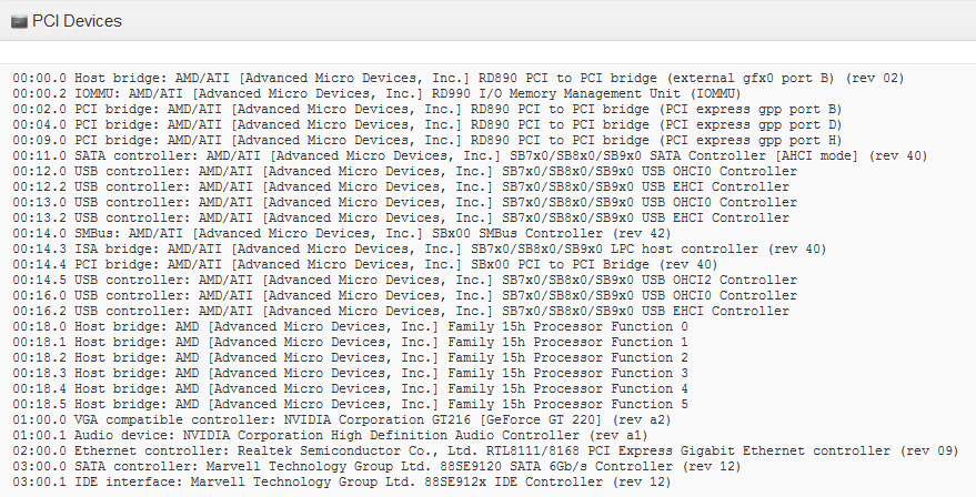

Yup, you are ready except it looks like you only have a nvidia GPU.  No graphics pass through has been working for us with nvidia cards just yet.  Hope you have an AMD GPU around ;-)
