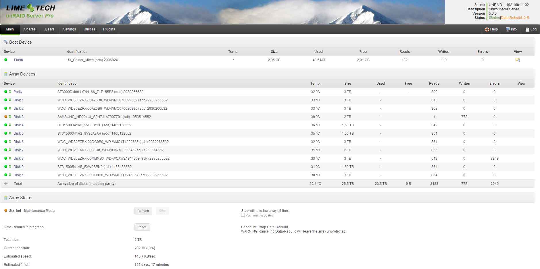

Please - need some help - while rebuilding drive, another goes offline, [SOLVED]
All drives have been precleared, and routinely checked (smart, filesystem,parity)

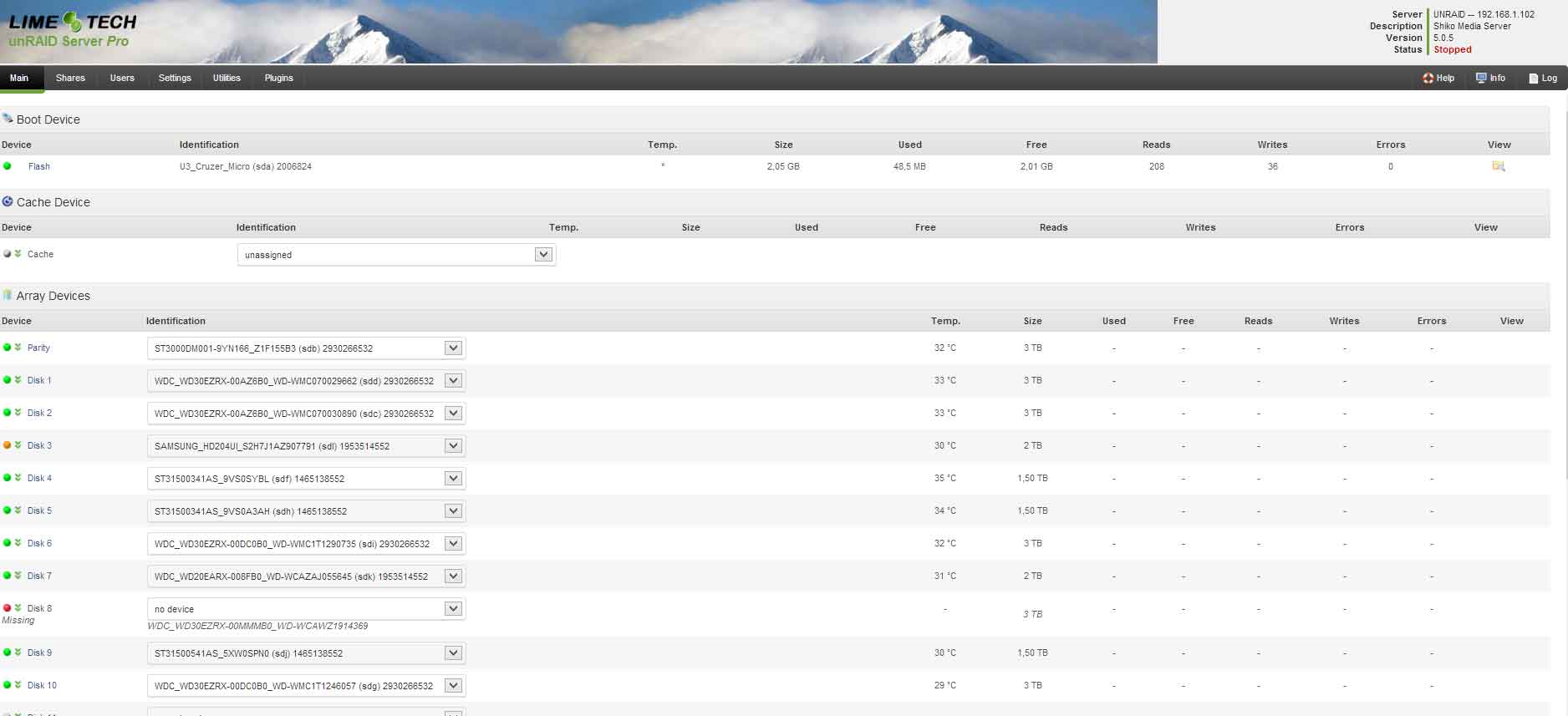

while checking reiserfs, disk3 went offline, tried to rebuild it, and another disk failed (8)
(i thought it was a Power issue, replaced psu to a 12v single rail 750w)
changed sata cable+power cable,
tried again, what happens is that drive 8 go offline while rebuilding disk3, every time,
in the sys log, system identifies bad sectors in disk8, what can i do?
how can i save data of disk3/disk8, is there any way to restore and ignore bad sectors?

don't know how, but after 15 times of trying, it slowly rebuilt my array, disk 8 shows 28,828 read errors
these are the smart RESULTS: (will take 8 offline+online and will try to rebuild it then check smart then report back)
