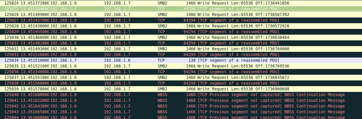

First thing I did was wireshark, The cap can be downloaded http://icedragonslair.com/images/unraid/wiresharkcap.rar
I looked at the capture and I'm a novice when it comes to reading them. I will have to play around with it further. Thank for taking the time to capture the data!

I've been looking over your wire capture and compared it against some local local testing between a Win8 system and unRAID. I'm wondering if you have enabled "jumbo frames?" What catches my attention is the write request for large length (65536 bytes?) followed by the tcp segment then another write request of similar size. Then we see some chatter about segments not captures. But also there's a lot of chatter back and forth as if there are errors, but I can't say that for sure. (See attached pix below)
I wish I knew more, it just varies greatly from what I saw in my tests.

The TCP trace i not enough to be useful but looks normal; 65536 is the TCP window size and 1466 is the maximum segment size. Jumbo frames is not the issue. After the speed is no longer abysmal you can investigate jumbo frames for further optimization. However, unless the networking hardware is sub-par the maximum gain is about 3% in a LAN. 3% is generally not worth the additional configuration management.
