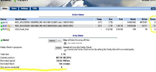

Hello
i install a fresh version of unraid 5.05 without any plugin.
I start in safe mode and do a parity check.
Again 55 news errors. :'(
Strange for me, but maybe it's normal in the WebUI, in the "Main" tab, in the "Array Status" zone:
at left, it was indicate "parity is valid" and at right "Parity has not been checked yet":

Hello
i keep the server running.
i just copy 4Go of data by samba and performed a new parity check.
The parity check isn't finished yet but errors increased from 55 to 72 and strange for me, in the WebUI "Sync errors corrected:" indicate 0.
I was missing something.
i put a new syslog at the end of the parity check.
thx for you help.
syslog3.txt

WaS
Hello all
new episode: dynamix disappear .. again :'(
after my last post, i use this command to mount my network harddisk:
mount -t cifs -o uid=nobody,iocharset=utf8 //2T/OpenShare/Videos /storage/downloads/2T/Videos
and begin copying 669 Go of data from my old disk to unraid server, while the copy in course, sickbeard put one episode on download in sabnzbd, dynamix still running.
This morning, copy still in course, i put around 6Go in download in transmission after the download i cleaned transmission, now i tried to connect to dynamix WebUI, nothing.
At the moment, copy and torrents downloads are both finished.
I didn't know if dynamix UI shutdown during copy and/or download, or just after but it's out again:'(
I can't understand why i have this problem!
Does there a debug mode i can activate?
If anybody have an idea, i take.
Thx
EDIT 06/03/2014:
Since i didn't mount my network hard disk, unraid and dynamix keep running perfectly.
I suspect sabnzbd create a folder in the path for the incomplete files so he'll fill the flash and i replace the hard disk he continu generate read error with better cooling.
EDIT 06/03/2014 Bis:
To good to be true: unraid/dynamix webUI shutdown again :'(
syslog11-mod.zip
