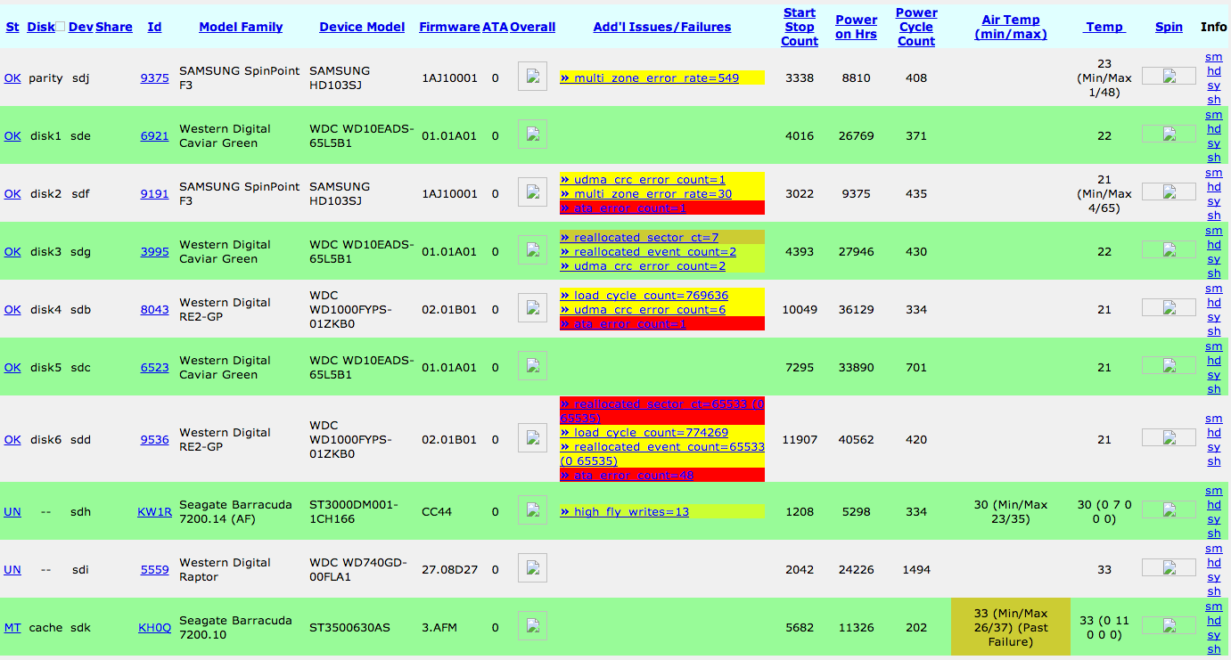

I installed unMENU on my unRAID6b5a production server for the purposes of getting SMART reports via myMain  in advance of parity drive upgrade.
I have my new 4TB parity drive cooking at gas mark preclear in my backup server but before I transfer, I thought I'd check my SMART report here (attached).
While all these 1TB drives will eventually be replaced, it really looks to me like Disk 6 is in bad shape. Should I be replacing this before I do my Parity replacement?

It looks bad. I would have already replaced it.
Also keep an eye on disk3 with the reallocated sectors it has.

But clearly disk6 is a disaster. You'd need to replace it

Nothing changed between before & after.
Ideally, I'd like to swap disk 6 with a 4TB drive I have pre-cleared but I'd need to upgrade parity first so I guess my steps are;
-replace disk 6 with another 1TB and rebuild it
-replace Parity with 4TB
-replace disk 3 with 4TB

We'll I've already gone ahead and swapped out Disk6 for another much fresher 1TB that's just been through a pre clear without issue so that's rebuilding now.
Next up I'll swap the parity and then once that's done, swap Disk3 for the 4TB. I have the time as y new 4TB parity just arrived today and is preclearing which will take a while.
