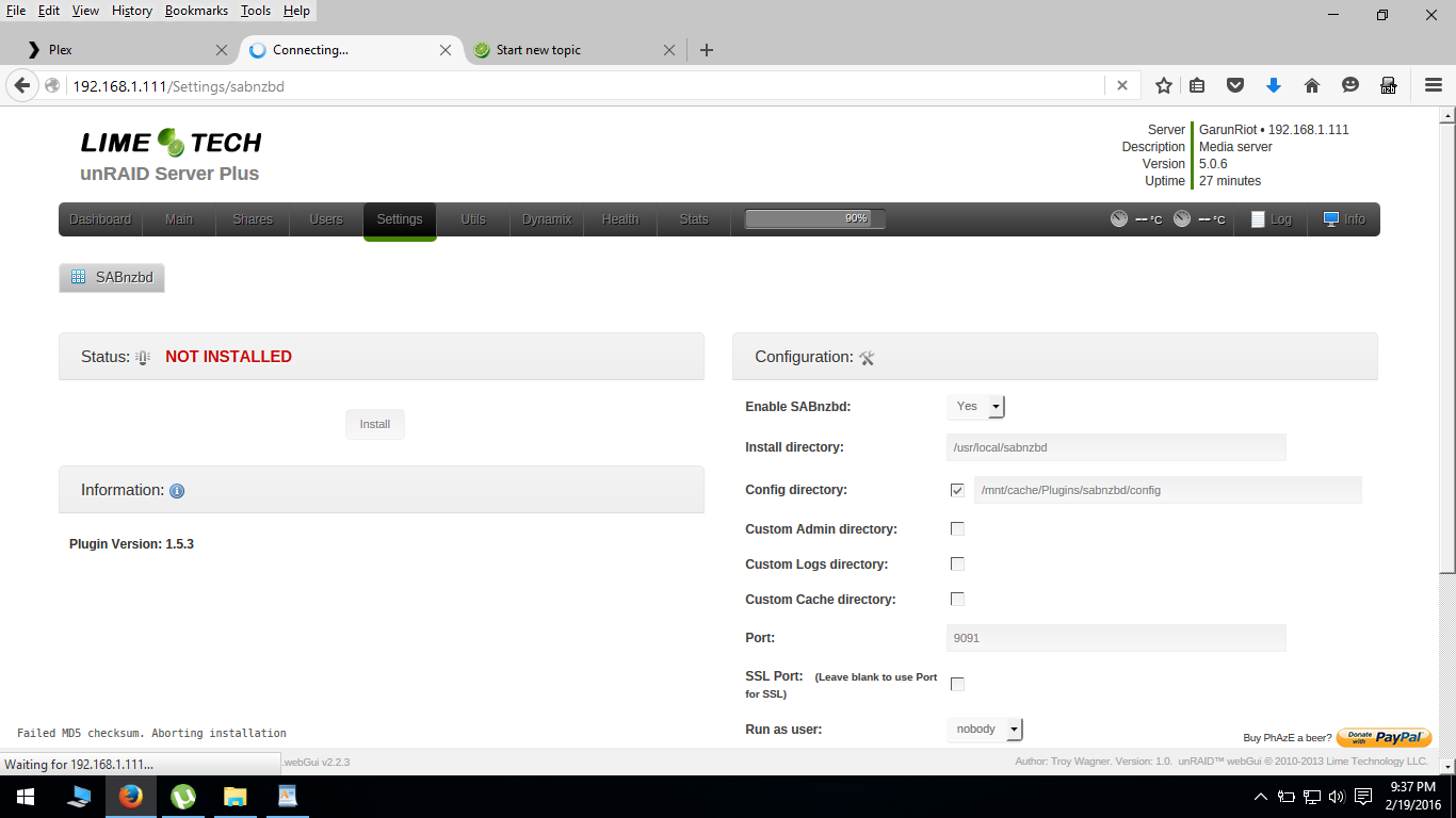

I restarted my server because my power went out. I check my PhAzE plugin to make sure everything is running properly.
I'm running Sickbeard, Couchpotato, Sabnzbd, and Transmission. Everything is connected through my server and running fine except SABnzbd. I kept getting error "failed MD5 Checksum" everytime I'm trying to reinstall.
Anyone know a solution to this? I can't grab anymore media files without sabnzbd running. Please help and thanks in advance.

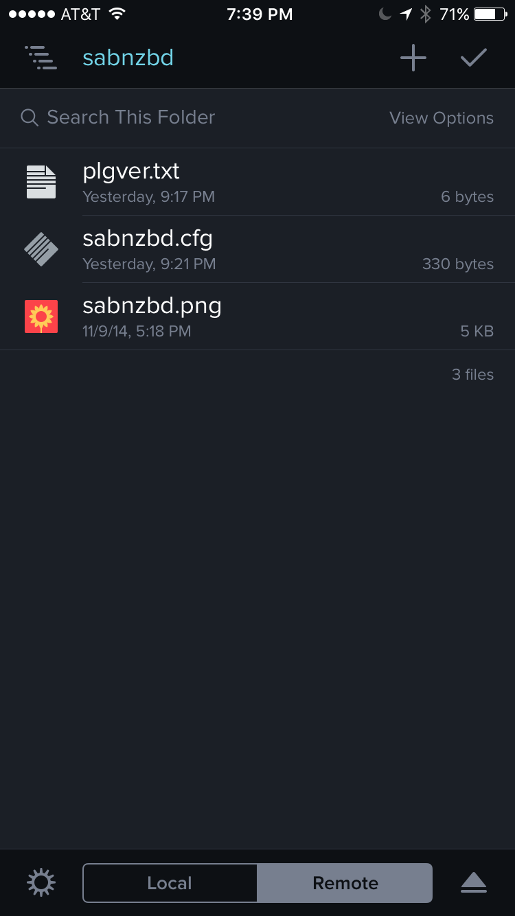

I'm doing this remotely on my phone through Transmit. Which file am I deleting exactly?
That... Doesn't look like the right folder. What version is your plugin at?
Your on your USB stick in /config/plugins/Sabnzbd folder?
All the install files are missing. A reboot of the server will force there plugin to download them again.
I search my file system for sabnzbd and I don't have any thing that end with .md5. I have a file with .ini and .bak.
Does your phone app have access to the usb stick? /boot is the directory for the usb.

I also searched the file system for all *.sab files and I don't have any for sabnzbd.
I checked in /boot/plugins AND /boot/config/plugins and there's nothing there for sabnzdb.

Hmm, there's nothing there. When I try to install the plugin I get an MD5 error that aborts.
Ok I see. This md5 error is when you install the plugin, not the app.
Sounds like you are having trouble downloading from github, not uncommon though.  In /boot/config/plugins make a folder called Sabnzbd (the capital matters on the s) and download the files from here:
https://github.com/PhAzE-Variance/unRAID/tree/master/AppSupport/Sabnzbd
You need control-2.5 and both dependency-1.7 files and put them in that folder. Then install the plugin again.

This happened after my server lost power. I'm unable to create a folder because my file systems in read-only mode. I suspect maybe I need to run fsck, but maybe you have an idea?
Read only would be a pretty big problem for installing anything to it. :)
I'm not sure the best way to do this. Perhaps one of the tools under the tools tab.
