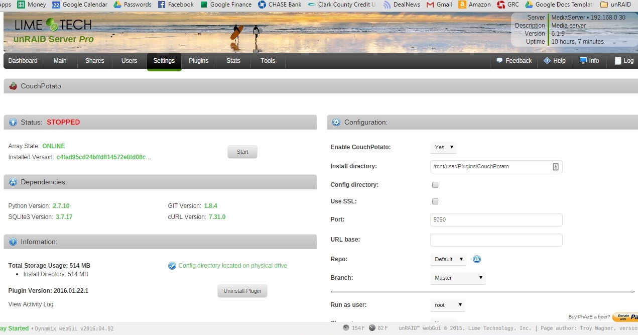

So my CouchPotato stopped working the other day, I think it may have to do with my upgrading to unRaid 6.1.9? I start the plugin and it says it's running, but when I go to the WebGUI it doesn't connect, and when I refresh the status page it says STOPPED. Originally I was getting the "No PID created error," but I uninstalled everything and deleted the common files as was suggested earlier... Everything came back but CouchPotato...
Here is the unRaid log from when I start it:
Apr 17 19:16:40 MediaServer emhttp: cmd: /usr/local/emhttp/plugins/Couchpotato/scripts/rc.Couchpotato buttonstart
Apr 17 19:16:41 MediaServer sudo: root : TTY=unknown ; PWD=/ ; USER=root ; COMMAND=/bin/bash -c . /mnt/cache/.PhAzE-Common/Couchpotato/startcfg.sh; python /mnt/user/Plugins/CouchPotato/CouchPotato.py --data_dir /mnt/user/Plugins/CouchPotato/config --daemon --pid_file /var/run/Couchpotato/Couchpotato.pid &
Apr 17 19:16:46 MediaServer sudo: root : TTY=unknown ; PWD=/usr/local/emhttp ; USER=root ; COMMAND=/bin/bash -c . /mnt/cache/.PhAzE-Common/Couchpotato/startcfg.sh; git --git-dir=/mnt/user/Plugins/CouchPotato/.git rev-parse HEAD
Apr 17 19:16:47 MediaServer sudo: root : TTY=unknown ; PWD=/usr/local/emhttp ; USER=nobody ; COMMAND=/bin/bash -c . /mnt/cache/.PhAzE-Common/Couchpotato/startcfg.sh; python --version 2>&1
Apr 17 19:16:47 MediaServer sudo: root : TTY=unknown ; PWD=/usr/local/emhttp ; USER=nobody ; COMMAND=/bin/bash -c . /mnt/cache/.PhAzE-Common/Couchpotato/startcfg.sh; sqlite3 --version 2>&1
Apr 17 19:16:47 MediaServer sudo: root : TTY=unknown ; PWD=/usr/local/emhttp ; USER=nobody ; COMMAND=/bin/bash -c . /mnt/cache/.PhAzE-Common/Couchpotato/startcfg.sh; git --version 2>&1
Apr 17 19:16:47 MediaServer sudo: root : TTY=unknown ; PWD=/usr/local/emhttp ; USER=nobody ; COMMAND=/bin/bash -c . /mnt/cache/.PhAzE-Common/Couchpotato/startcfg.sh; curl --version 2>&1
And here is the error log I think...
19:16:57 CRITICAL [                __main__] Traceback (most recent call last):

Out of curiosity, try setting the config for to use your cache drive instead of /mnt/user

So that user share was a cache only anyway, but I redirected it to /mnt/cache/Plugins/CouchPotato/config which was the same place it was before, and the app loaded and ran, but it was in wizard mode to start over. I tried several times to restart and redirect the config but every time it would do the same thing from before where it would run for a second and then show as STOPPED. I think maybe the database got corrupted somehow?
Yes if you can get it running on a fresh config directory, it's very possible the db is corrupt. I've had it happen on my install before as well unfortunately.
Make a backup of your config directory and see if you can remove the db only, keeping the rest of the config files. Set it back to your /mnt/user directory and see if it runs.
Okay, I took my config backup from before I started fiddling, put it back in there and deleted the database folder. I started the plugin and I guess it must have restored from the db_backup folder or something because it's back to where I started I think, thanks so much!
