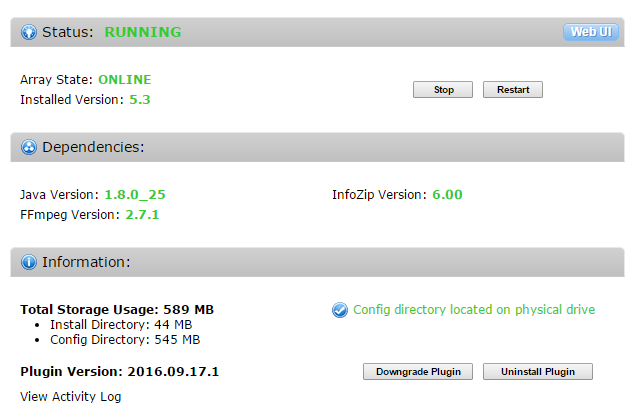

I just installed this plugin fresh and 6.0 gets installed.  What version do you see currently installed?
From command line run: /etc/rc.d/rc.Subsonic latestversion
That should say 6.0. I'll also need to know the unraid version you are running.
I am seeing:
Installed Version:5.3
Plugin Version: 2016.09.17.1
I am still using unraid 5.0.6
When I run that command I see nothing.
root@Tower:~# /etc/rc.d/rc.Subsonic latestversion
root@Tower:~#
Attached screenshot will give you the details of my current install of subsonic.
