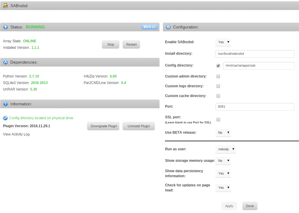

The settings as requested (should be attached as a png file. I wasn't sure how to make it appear inline in my post).
Just wondering why you requested them?
Skunk

Please post your settings from the plugin page.
Sent from my SM-T817W using Tapatalk
Skunk
Lol thanks, it's because I replied to the wrong post! But uh.. looks all good anyways :)

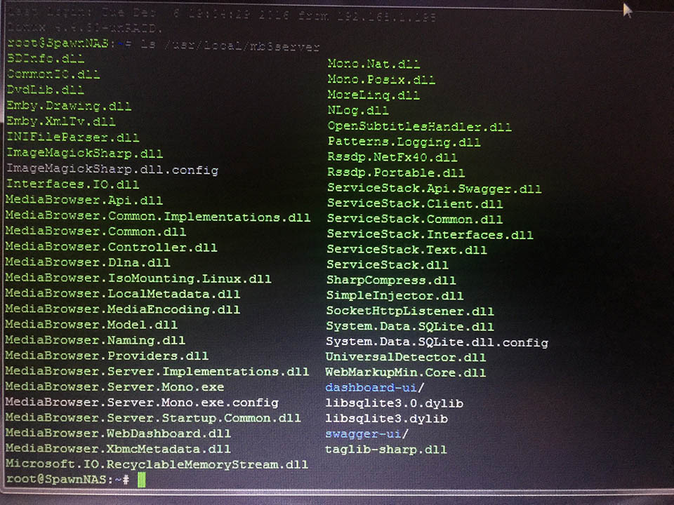

Ok, Im a little lost.  Sorry not great using linux.    my installed location is  /usr/local/mb3server  (see attached imgs).  I do not see my config folder in that installed folder.... my config location is  /mnt/cache/mb3server/ProgramData-Server.  which i can access to via Window OS
So can i just delete /usr/local/mb3server?  and dont touch the Config location in Cache.

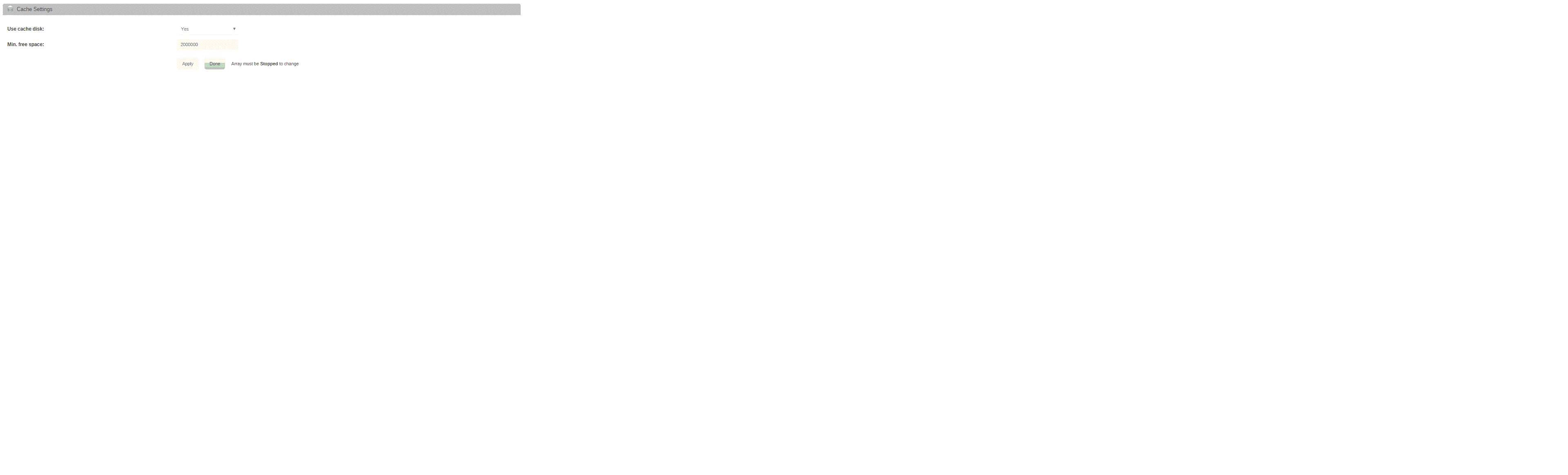

Are you referring to this setting trurl??
Attached.
