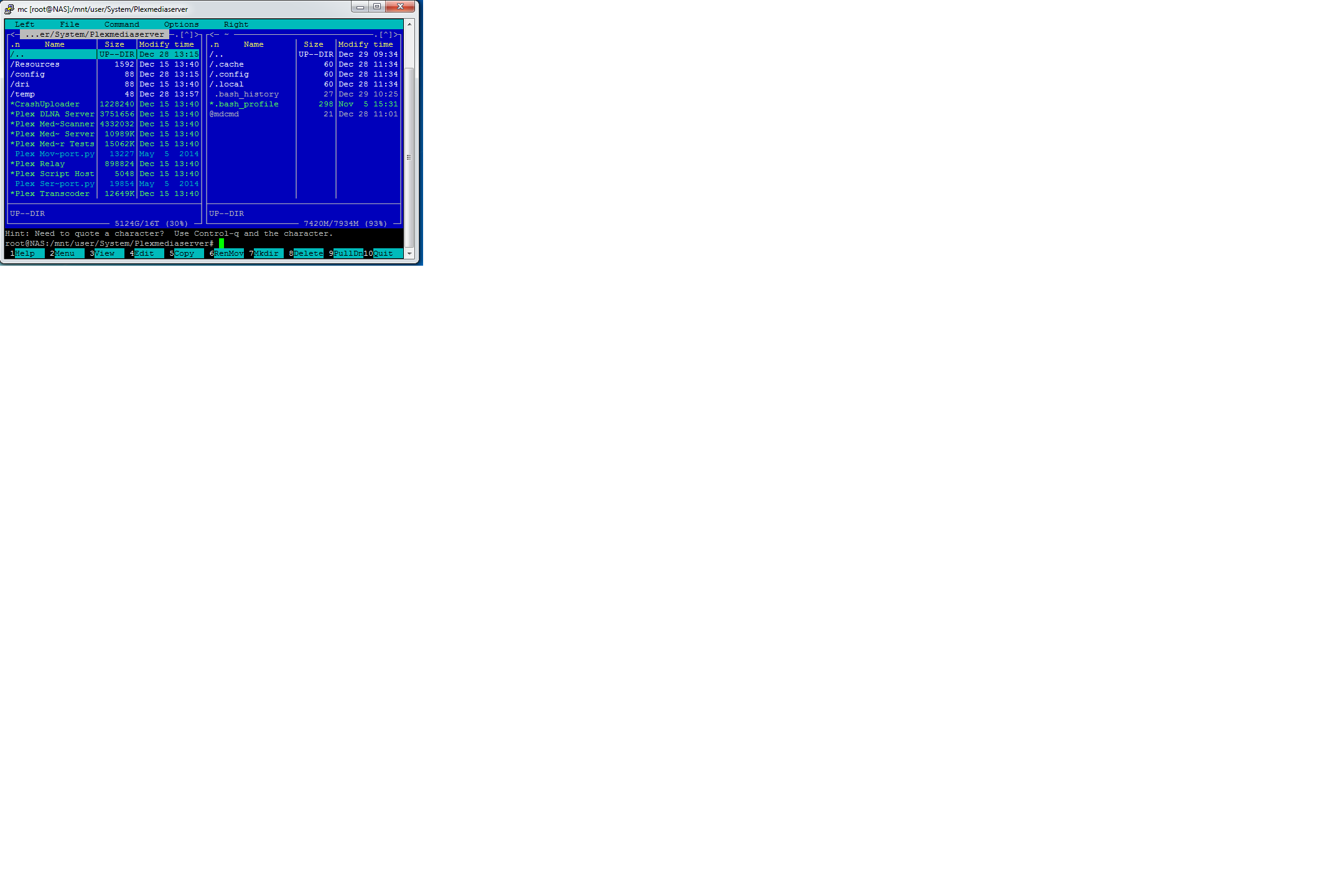

It is in your appdata for plex.
Where is the app data ?
I made a screenshot to show you my plex folders.
thanks
Which version of unRAID? Maybe a screenshot showing your plex plugin settings would be more useful.
