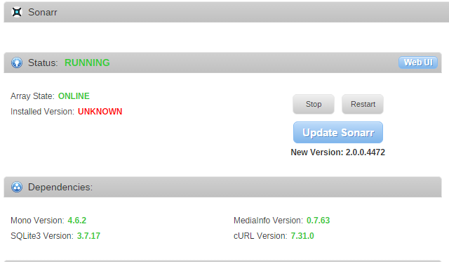

SONARR plugin, "Installed Version Unknown" error.
Is anyone else having this issue?
Attached is a snip of the plugin web interface.  The installed version (according to Sonarr->System->About) is 2.0.0.4472.  I'm betting the "unknown" version is prompting the update Sonarr button, but what is causing the unRAID interface for the plugin to not recognize the version in the first place?
Is this something wrong with the plugin or is it a problem with Sonarr itself?
And, how can I fix this?
I have already completely removed Sonarr and reinstalled, I have tried to "update Sonarr" using the button and from the CLI, and I have also tried a fresh install of unRAID on a clean thumb drive and installed the plugin from scratch.  All efforts end with the same results (see attached).
Thanks in advance for any assistance.

They made a change in how the output of the version information is displayed. The app will still work even if that shows as version unknown. I'll need to update the plugin to fix this cosmetically.

I've updated the Sonarr plugin to correctly grab the 'installed version' again.  Tested install, works fine, repeated install multiple times without issue.

2017-02-15 23:29:11 [WARNING] Unable to get latest version from online - Checking USB for any install file
2017-02-15 23:29:11 [ERROR] Install failed: Install file missing
Try this:
Edit the sonarr.plg file in /boot/config/plugins folder. Look for the variable called appurl and its something like
Update.sonarr.tv...
Change it to download.sonarr.tv (replace update with download) then test the install again. Ill check for the direct download command if this doesnt work.
8) Perfect!  The direct download link worked instantly..  Strange that this one plugin won't auto download even though everything else works fine (15+ plugins)  8)
Thanks for checking back!
Edited by liquidkaos

Interestingly enough, I had to update Sonarr with wget again using the latest version number.  This worked, but automated updates only for this plugin seem to be failing (same with original install).  This is a fresh 6.3 system, very strange.
