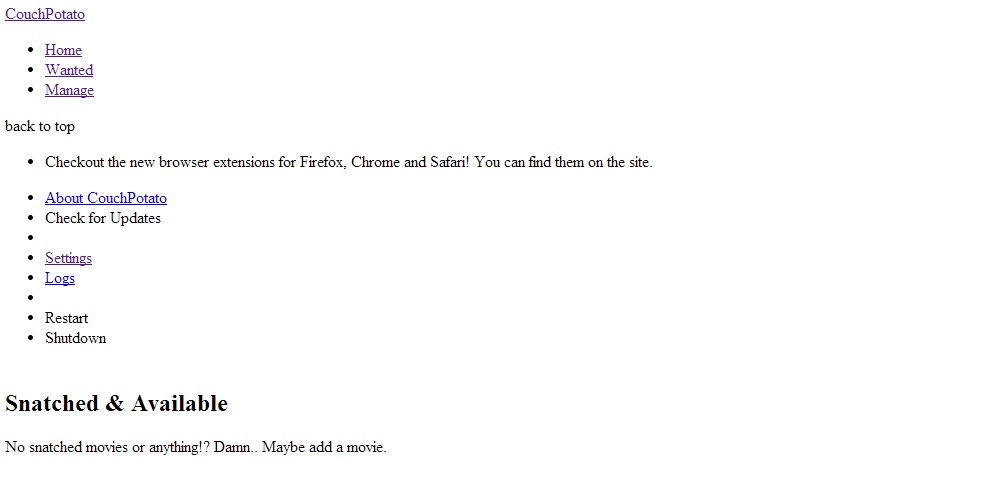

Hi guys,
Just tried the plugins for Sab, Sick beard and CP. All working well except for CP.
I did have a previous version installed, but its been playing up recently and wasnt starting, so decided to start fresh. I used different Install and config paths to the previous installs.
The CP service starts however the page appears flat with no formatting. As Attached:
Any thoughts on where I can start troubleshooting?
thanks in advance
Hi guys,
thanks in advance
What other plugins are you using and which version of unraid? Have you tried a reboot of the system and also if you are running unmenu do you have g++ and GCC installed?

Hi guys,
thanks in advance
