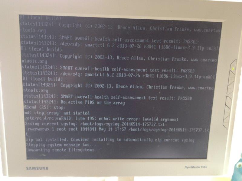

I stopped the array and powered down, however the array hangs at unmounting remote file system, see attached jpg It is also stating the zip is not installed?

It is probably trying to unmount a disk but that disk has a file open.  This is usually caused by either a computer on the network reading a file or a plugin on the unRAID server.  Can you still access the server with telnet/putty?  If so then you could use a command that identifies open files and kill the process that has it open.  However I don't know that command as I use the unMenu GUI to tell me what files are open so I don't know it off hand - sorry.  Hopefully someone else has better advice.

I can't telnet in, and don't know what to do next. The array was stopped properly, and I was not aware of any file being being open
Wish I could advise you further but your past where I can offer any advise now.  Hopefully someone else can take you further.  If no answers here you might try emailing limetech they might be able to help never had to go that far myself yet so can't advise you on that route either.
