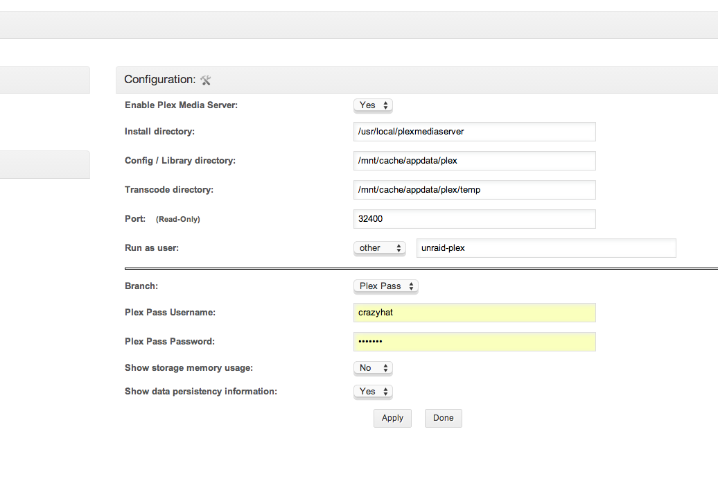

attempted this on unRAID 5.0.5 this morning and it will not start.
My original plex installation was /mnt/cache/apps/Plex
My original temp was /mnt/cache/apps/Plex/Temp
so.... this is what i did:
1.  Deleted the old plugin's settings folder
2.  Moved the plex Library data out of that Application Support sub directory
3.  Deleted the now empty Application Support directory
4.  Deleted the .txz file
5.  Rebooted with new plugin
6.  Set it up as per the screen shot
Anything obviously wrong?
Version also doesn't work and on my unRAID console i get the following error:

Settings look ok to me. If you have any other issues, try setting the RUNAS user to 'nobody' and hit apply. That will reset all the permissions on your database though and amy take a few minutes to complete.  No need to run as 'plex-user' with my plugin, I think that was a limitation from the old plugin.
Don't worry about the segfault, when the program installs, none of the config files exist so I force it to do a version check on itself knowing that it will segfault. By doing that, the config files are created when it segfaults and then it doesn't occur again.  For some reason, plex devs haven't made the program smart enough to realize config files are missing and to just create them and continue loading, and instead throws that segfault on the very first launch of the app after a fresh install (only on linux).
Hmmm I did actually try those setting under both nobody, root and unraid-plex, to the same result (this is unraid v5).
After I hit apply the webgui would say plex was running I'd check it in the plex web app to see the server listed, then start watching something via my plex desktop app and 2 to 5 mins the show would freeze. I'd check the web app the server would no longer be recognized and in Unraid console would still say everything was running fine...
I've switched back to the old txz file (my family gets upset with the server down too long).
I did get it working in unraid 6 no issues so it must be a conflict with my v5 setup.
Thanks for you help and hardwork on this I did notice a speed increase and am looking forward to using the plugin when I do work out all the issues with a V6 upgrade!

New question, and it might be plex or maybe not, not sure but most server settings under plex I can not save. I just get "Your changes could not be saved."
This was working on 9.9.13 under influencer, which is why I dont know if its plex or possibly the plugin (since switching to your's I have been on 9.9.14 and now 9.9.15.
Anyone else experience this? Settings do save under Web, just not sErver.
when i switch over to the other plugin it works fine though, which is what is weird to me. No other thoughts?

Hmm, I haven't come across that problem. Try this:
In the plugin settings change enable to no
Then change run as user to root and hit a apply
After a few seconds (or minutes if you have a large database) it will complete, change it back to nobody and hit apply
When that complete, start it up again and check

no go on that try.
