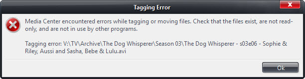

but when I then tried to manipulate some files with my media player, it failed, telling me I didn't have permission to do so.
So then I ran ls -l on the directory that contained the files that failed, and I got this result...

This continues to be a problem for me.  A recent example is that my media player tried to automatically 'tag' some new videos, and gave me an error that it was unable to modify some files, and to be sure they were not in use or locked.  here are the permissions of the files it warned me about...
root@media:/mnt/user/video/TV/Archive/The Dog Whisperer/Season 03# ls -l
total 2864608
-rw-rw-rw- 1 nobody users 366309376 Jan  1  2009 The\ Dog\ Whisperer\ -\ s03e02\ -\ Buster,\ Holli,\ Spike\ &\ Belle.avi
-rw-rw-rw- 1 nobody users 366286848 Jan  1  2009 The\ Dog\ Whisperer\ -\ s03e04\ -\ Wilshire\ and\ Butch.avi
-rw-rw-rw- 1 nobody users 366295040 Jan  1  2009 The\ Dog\ Whisperer\ -\ s03e05\ -\ Maya,\ Sara,\ \ and\ Lilly.avi
-rw-rw-rw- 1 nobody users 366311424 Jan  1  2009 The\ Dog\ Whisperer\ -\ s03e06\ -\ Sophie\ &\ Riley,\ Aussi\ and\ Sasha,\ Bebe\ &\ Lulu.avi
-rw-rw-rw- 1 nobody users 366319616 Jan  1  2009 The\ Dog\ Whisperer\ -\ s03e07\ -\ Bella\ &\ Big\ Boy,\ and\ Gracie.avi
-rw-rw-rw- 1 nobody users 366327808 Jan  1  2009 The\ Dog\ Whisperer\ -\ s03e09\ -\ Woody\ &\ Wally,\ and\ Kane.avi
-rw-rw-rw- 1 nobody users 366340096 Jan  7  2009 The\ Dog\ Whisperer\ -\ s03e16\ -\ Hope,\ Maureen,\ Chloe\ and\ Sam.avi
-rw-rw-rw- 1 nobody users 366297088 Jan  7  2009 The\ Dog\ Whisperer\ -\ s03e18\ -\ Amber,\ Snoopy,\ and\ Schroeder.avi
Permissions look fine and I would expect any user to be able to make changes to these files, but it seems I'm not able.
How can I help diagnose and resolve this issue?
attached is one example, not the one I described above, as I've already corrected those permissions.  This is just one recent one.
