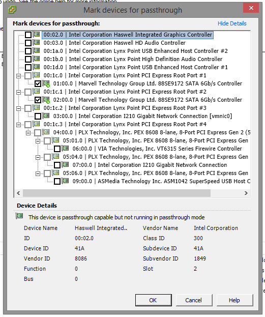

I just got my ESXi server up and running but I can seem to find out how to passthrough the onboard Intel c226 SATA controller to the unRAID VM.  I have a Asrock c226 ws motherboard with a xeon 1245v3 CPU.  I also want my data store to be on one of my marvell controllers but whenever I have to SSD plugged into the marvell controller ESXi will boot but my data store is not there.
Had the same problem. Moment I tried to pass-thru the onboard Intel sata ports, all other onboard sata/external sata cards was not visible. I had no choice but to use the Intel sata port for my lone SSD datastore drive, wasting the other 5 sata ports unused.

I'm not aware of any that do individual sata ports as it is the controller that needs to be passed through.

Because of ESXi not allowing me to pass-thru the Intel sata ports, I had various old PCI/PCI_E 1X sata cards lying around.
They all worked and was able to pass-thru all the cards to unRaid.
I settled for a DELL PERC H310 in IT mode I bought off ebay.
