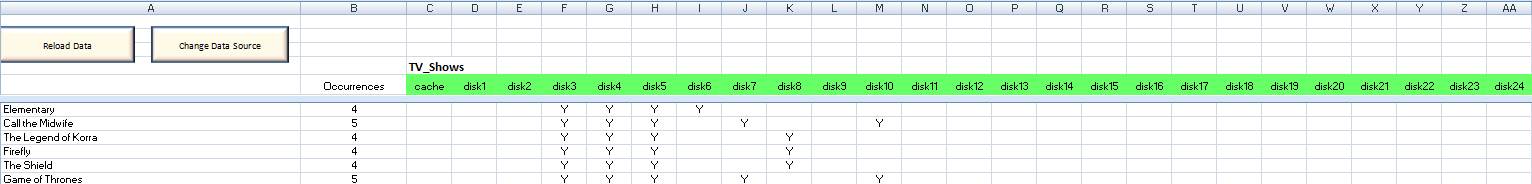

June 8, 201412 yr In the past I wanted a utility that would show me how my data was distributed across the various disks on my Unraid server. As I was never able to find one, I decided to build my own. I decided to use Excel VBA as I can usually hack together code to achieve what I need to do. This code could be more elegant. Feel free to modify it to suite your needs. . I am sharing this as others may find it useful. To use this workbook, you must enable macros in excel. All of the shares you want to work with, including disk shares, on the Unraid Server must be “Exported” via SMB and Public. You may need to spin up all of your drives to keep it from timing out. What this workbook does is take a listing of all the directories on a top level share on your Unraid server that you enter. It then builds a list of all of the top level directories. The next step is to cycle through all of the disk drives and build a list of the top level directories of the selected share on the appropriate tab. Starting in column “C”, a formula is written that checks if the directory to the left is in disk tabs. If it is, it will put a “Y” in the cell under the appropriate disk. There is no check other than that the directory exists. It can be empty. How to use this tool: On the “Input Data” tab, enter the Unraid top level share name starting in cell “B22”. If you need more cells, just insert a row(s) in the middle of the existing rows. This way the range will dynamically expand. Edit 2/1/2106. Don't do this. Enter the IP address off your Unraid server in cell “B14”. Pick the share you want to work with in the drop down list in cell “B15” Turn Screen updating on/ off in cell “B16”. Setting it off (Yes) speeds up the macro. Click the “Reload Data” button to run the macro. Hopefully you find this workbook useful. NOTE: Warning: I have noticed that the first time the excel script to build the Rsync sheet/commands has an error. When you select a destination drive, the directory it picks to move is one row off. You should run the report a second time. It seems to straighten itself out after that. . After you have ran the report a second time, save a copy of indexer and use that version going forward. I have not been able find out why it is doing this EDIT NOTE. I updated the utility to version 4 below and changed the Subject of this thread to reflect the new functionality. http://lime-technology.com/forum/index.php?topic=33689.msg328265#msg328265 EDIT NOTE 10-31-2014. I updated the utility to version 4.07 below. http://lime-technology.com/forum/index.php?topic=33689.msg328265#msg328265 Indexer v 04.07.02 - https://drive.google.com/folderview?id=0B8FJEotSXLrxQllJdTBrVmxNd2c&usp=sharing - UPDATED: 3-1-2015 Adds the “undist.sh” script to the zip. Indexer v 04.07-02-06 - https://drive.google.com/file/d/0B8FJEotSXLrxcFptMmVCVTZYN1k/view?usp=sharing. Added formulas to dynamically display the disk with the largest utilization of each directory. See this post. http://lime-technology.com/forum/index.php?topic=33689.msg415201#msg415201
June 9, 201412 yr Author Attached is a revised version of the workbook. I added the capability to retrieve the size of the directory on each disk for the share. You can select the unit of measure you want to show. You can show the capacity in GigaBytes, Gigabits, MegaBytes, Megabits, KiloBytes, Kilobits or Bytes. You can change the value to any unit of measure you want. You can also get a listing on a per disk basis for all of the files in the share on a per disk basis, or for the entire share. The data provided should give enough information to assist in performing disk cleanup/directory consolidation. You can see the capacity used on a per disk basis to assist deciding were to move the files. If you use the workbook, if you would not mind posting a message in this thread indicating you used it, I would appreciate it. I am just curious if anyone else finds it useful.

June 29, 201511 yr This is really cool. I love the matrix view to understand which folders are on which drives. I am trying to clean up my server and arrange things a bit better now that I have a few larger drives than I had a few years ago. I would love to see this type of functionality built into unRAID. I think this thread should be moved to where it will get higher visibility.
