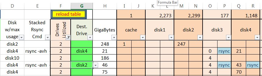

I’ve updated my spreadsheet, Indexer v 04.07-02-06, to display the Disk with largest quantity of data for each directory in the “Rsync Command” tab. using the attached jpg as a reference, you can see this data in column D.  Previously as you can see in the picture, you would make a decision as to which disk you wanted to consolidate the directory onto.  The majority of the time it is probably the disk with the largest quantity of existing data.  You would determine which drive it was then select the disk in the destination drive cell.  Now you can copy the all of the data in column D, starting on row 10, paste, using PASTE SPECIAL VALUES, it into the corresponding cells in column G.  Then use the filter in column F to only display values greater than 1.  This will then show you a list of the directories that you want to work with.
You can still select each disk individually if you want.  In the example you can see that I have selected disk2 and it will build the rsync command(s) to move the data from disks 3&4 to disk2.
