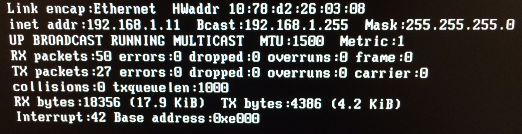

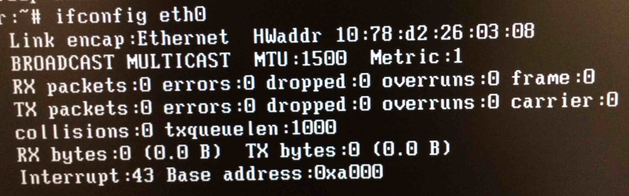

I have trouble connecting to the web interface reliably.  When I can connect to that I have trouble staying connected to shares.  I have tried updating to a newer release (I was on rc12, now on the current release) and have have same issues on and off since.  I have even installed unraid on a new flash drive and seem to have a similar issue.  I attached the current ifconfig.  Any suggestions on my next step?  Everything else on my network seems to be working fine and I have tried a different router.
I have tried new cables and even a different router, so I don't think that is the problem.  This is the ifconfig when I use the new virgin flash drive.  I don't have a pro license for this one so I would rather use the previous one, but don't know if its as simple as deleting a few settings and starting over or what.  Also, I was able to access the web interface from this new drive.
Well I sorted out why one drive was connecting but not the other by replacing the network.cfg file on the old drive.  It seems to be working now, but I still am getting the interrupt 42 error on the new drive.  I have not rebooted the Unraid server because I am just happy it is working for now.  I some spare drives coming in today to copy some important stuff to before I try rebooting to see if it is really sorted out.  Anybody had the interrupt 42 error before?
