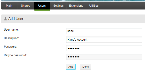

I can't seem to create users with Beta 6.6.  I go through the webgui, all looks good.  CLick add and it takes me back to to ther add user screen, no error.
The l;ogfile shows the following:
Aug 10 16:37:53 tdm emhttp: shcmd (108): useradd -g users -d / -s /bin/false -c 'Kane's Account' kane |& logger
Aug 10 16:37:53 tdm emhttp: _shcmd: shcmd (108): exit status: 1
Aug 10 16:37:53 tdm emhttp: shcmd (109): chpasswd <<< kane:"*****"
Aug 10 16:37:53 tdm emhttp: _shcmd: shcmd (109): exit status: 1
Aug 10 16:37:53 tdm emhttp: shcmd (110): smbpasswd -L -s -a kane <<< "*****"$'\n'"*****"
Aug 10 16:37:53 tdm emhttp: _shcmd: shcmd (110): exit status: 1

I then look at the user list from the webgui and user I tried to create isn't there.
Doing a cat /etc/passwd shows the list of users but not the new one I tried to create.
Any advice ?
What user are you trying to create?  It should be alphanumeric and lower case.
It is.  See attachment.  The user is "kane" without the quotes
Another dump of the log from this attempt
Aug 10 17:26:00 tdm emhttp: shcmd (120): useradd -g users -d / -s /bin/false -c 'Kane's Account' kane |& logger

Just a thought - it might be worth removing the apostrophe from the Description just in case that is upsetting some of the parsing behind the scenes.  Other than that I have no idea.
Well done, that was it. Thanks.

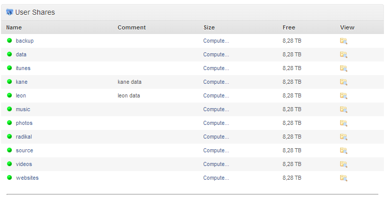

I've finally tracked down another error that's been screwing with me since version 6.6.
Every know and again my User shares would become inaccessible.  I need to stop and start the array to get them back again.
I spent sometime today trying to replicate it and i have.
The first attachment, sharesgood.png, shows my current shares.  All if good.

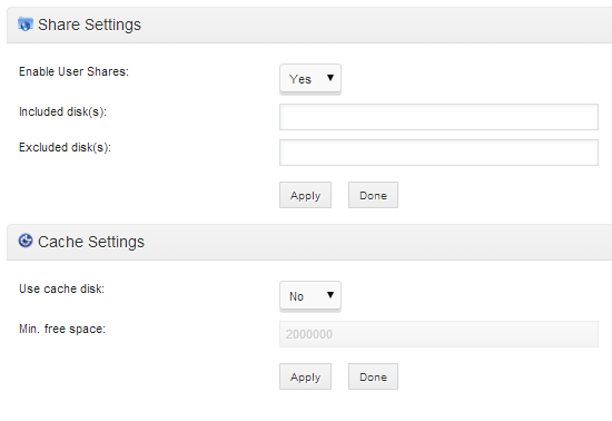

On the webgui I click on settings, Share Settings.  The settings are fairly basic.  see attachment sharesettings.png
Without changing anything, I click "Apply" in the Share Settings section. The page updates and returns fine.
Here's the syslog of what happens when I do that:

I click on the Webgui Shares page and here is what I see, to my initial horror. sharesgone.png attached.
The shares can't be reached.  I need to stop and restart the array to get the shares back.
Is this a known bug ?  Or something new ?  Or something only I'm experiencing ?
In case anyone is seeing the same thing, this is a confirmed unRAID bug.
