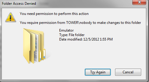

I think I tried to fix this once before but got fed up with it... now I'm running some new setups after a long time of waiting and I think my unraid box is having trouble communicating with xbmc properly (shows being left out of parsing for no reason, etc, etc... i have threads open in the xbmc forum).
Anyways, I booted into 5.0-rc12a from (I believe 4.7) some time ago and never was able to retrieve file/folder rename ability... I ran the permissions script from the web GUI that I think is supposed to fix this exact issue but it didn't work... I've ran it a few times with no success (no fix, rather- the script runs just fine and says it is successful).
See attached for syslog and error messages. I do see this problem in the forums but I'm having trouble following the instructions that already exist to try to remedy... figured I'd give it a shot just asking for my own help here.

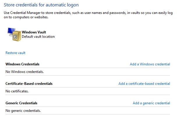

If you upgraded from 4.7 you probably need to delete the credentials stored in Windows.  Unless you've got multiple users on unRAID you shouldn't need to supply any credentials to access unRAID (assuming default share export).
Instructions http://windows.microsoft.com/en-CA/windows7/remove-stored-passwords-certificates-and-other-credentials
There's nothing in here to delete... (see attached)
I don't have multiple unraid users (or multiple windows users) - 1 each

What were the permissions of the files on your array?  They should have been nobody:users
What are you changing them to?
I think that's what they were, I feel like I saw that somewhere...
I haven't really been sure what to do but I was stumbling around in windows security so I tried to send permissions using the following dialogs (inherit from parent)... I don't really know what this'll do... but nothing else has been working so...
