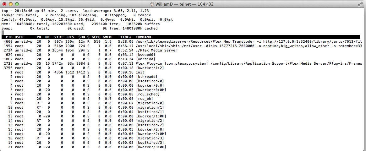

I've booted without XEN this time.
Not sure what is going on, maybe its memory? A lot used but not for plex. It doesn't seem CPU related.

If your performance issues go away when booting to non Xen mode, you were experiencing a Xen specific issue...
And the majority of your memory is allocated to cache and buffer space, which isn't really consumption.  You're barely pushing the needle in your system resources right now...

Thanks Jonp.. how do i push the needle!

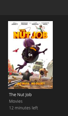

Performance for plex in docker is the same with or without xen boot. I'm transcoding a 15gb mkv which for the same movie in a win8.1 xen VM would run at 24x speed. Now in docker it is running at x6
CPU is working enough...
