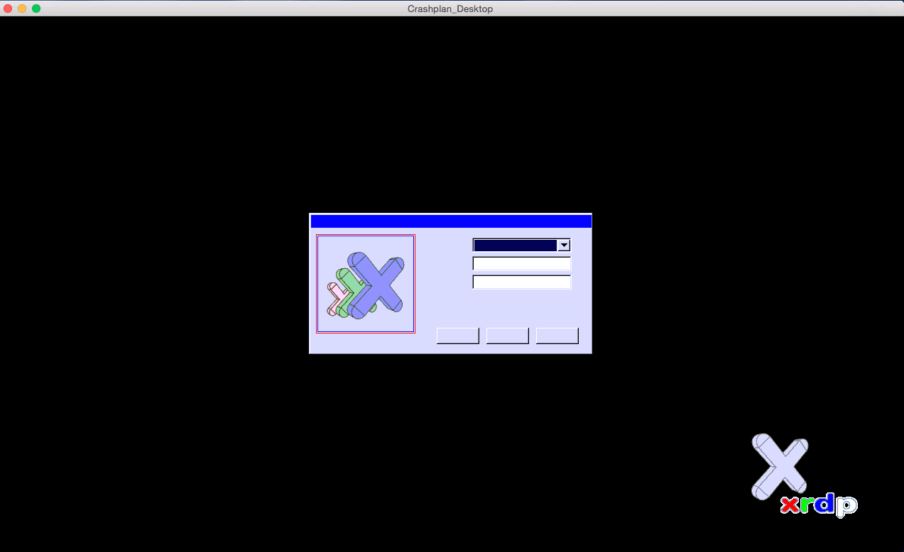

Hi All,
I installed Crashplan + Crashplan_Desktop successfully. However, when I try to run Crashplan_Desktop, the graphics don't fully load in remote desktop and I can't input the login information.... What could be wrong? I attached a screepcap for reference.
Thanks in advanced,
Are you using a Browser with Remote Desktop extension? Only thing I could think of is an AdBlocker causing the problem.
Hi Leifgg,
I'm using Jump Desktop, Mac OS RDP/VNC client. I also tried Microsoft's RDP client for MacOS , but non of the graphics show up. I tried uninstalling, and installing but no avail. :(
Unfortunately, I am not using a Mac so it’s a bit difficult for me to help. Using Microsoft RDP and mRemoteNG in Windows and have never seen this behaviour.
I believe that this container is using the Libre-Mate container by sparklyballs as a base so it might be worth looking at or posting in that thread as well.
The problem is not CrashPlan related, it probably has to do with the Linux desktop and/or Linux xrdp used in that Container.
Hope that somebody with a Mac can respond!
