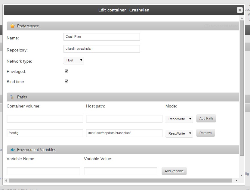

7) Configured pretty vanilla, matching the screenshot from above (with the config mapped here: /boot/config/custom/appdata/crashplan)
8) Looked like there was a chown issue on the start, but I can't find it now...
9) Tried to start Crashplan, and it stops in just a second or two.  Checked the logs, and here's what it says each time I try to start.
*** Running /etc/my_init.d/config.sh...
chown: changing ownership of ‘/config/id’: Operation not permitted
chown: changing ownership of ‘/config/cache’: Operation not permitted
chown: changing ownership of ‘/config/log’: Operation not permitted
chown: changing ownership of ‘/config/conf/custom_sample.properties’: Operation not permitted
chown: changing ownership of ‘/config/conf/default.service.xml’: Operation not permitted
chown: changing ownership of ‘/config/conf/service.log.properties’: Operation not permitted
chown: changing ownership of ‘/config/conf/ui.log.properties’: Operation not permitted
chown: changing ownership of ‘/config/conf/ui.properties’: Operation not permitted
chown: changing ownership of ‘/config/conf/upgradeui.log.properties’: Operation not permitted
chown: changing ownership of ‘/config/conf/upgradeui.properties’: Operation not permitted
chown: changing ownership of ‘/config/conf’: Operation not permitted
chown: changing ownership of ‘/config/bin/run.conf’: Operation not permitted
chown: changing ownership of ‘/config/bin’: Operation not permitted
chown: changing ownership of ‘/config’: Operation not permitted
*** /etc/my_init.d/config.sh failed with status 1
*** Killing all processes...
Any thoughts?  I don't know much about docker, so will need a little help in that regard if there's a config issue there.
Thanks for the help!
I don't see anything specials that would make it fail.  Did you try having the /config to the cache drive instead ?  (/mnt/cache/appdata/crashplan")
Seems to have worked.  Why did that work for gfjardim in the above screenshot?
Update:  Everything is working fine - still not sure why the above screenshot didn't work for me in term of folder mappings.  Have the client connected, and am resuming previous backups.
