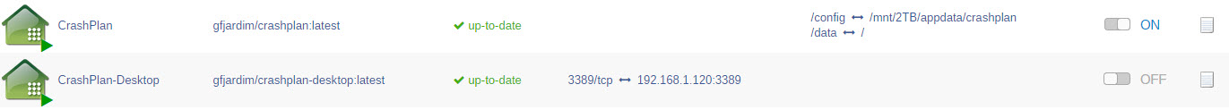

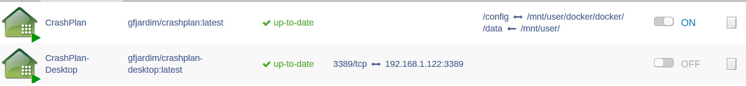

What does your docker page look like?

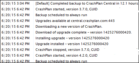

The CrashPlan engine Docker will not update from 3.7 to 4.2 automatically, the developer of the Docker would need to update it to pull the new release.
Edit: See correction in Reply #213 below
Well, supposed to or not, my CrashPlan engine Docker managed to get itself up to 4.2 somehow...

I was wrong when I previously said that the CrashPlan Docker engine couldn’t be auto updated. Sorry about that!  :'(
Did a check in the app.log in the log directory and can confirm 4.2.0 running as mentioned by guygg in the post above. If you stop and start the Docker the version will remain the same but if you force update the Docker it will load 3.7.0 but it will immediately update itself to 4.2.0.

Same problem as others, it looks like when an update is found on the Docker page, if you click on upgrade it moves the Crashplan version to 4.2.
If you uninstall the Crashplan Docker and Re-install to 3.7 this wipes out your saved cloud files and starts the backup process from the beginning.
If you restart your server and manually start the Docker it appears to force the update if an update is available.
App.Log in the crashplan docker folder: CPVERSION    = 4.2.0 - 1425276000420 (2015-03-02T06:00:00:420+0000) - Build: 61
