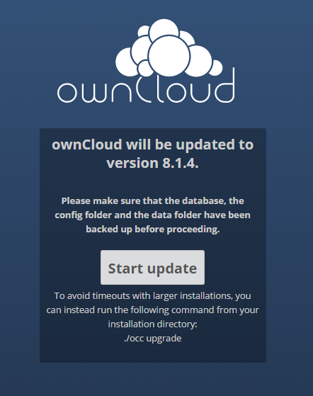

After I tried to update I can't seem to get this screen to go away and go back to the login screen.
I've tried:
[*]Waiting
[*]toggling maintenance mode on and off in the config manually (which will put it into maintenance mode, but toggling it off brings it right back)
[*]going into docker itself to run occ (however it seems as if the owner / executable-ness needed to be fixed up)
[*]After changing the permissions of occ and /config/config.php to run occ, I received a "Bus error" and can't seem to get farther than that.
[*]Restarting the docker image
I did notice that the config.php has version 8.0.4.2 and that the version.php file has 8.1.4. Any help would be AWESOME. I've been working on this for a few hours and am at a loss at this point.
I've tried:
[*]Waiting

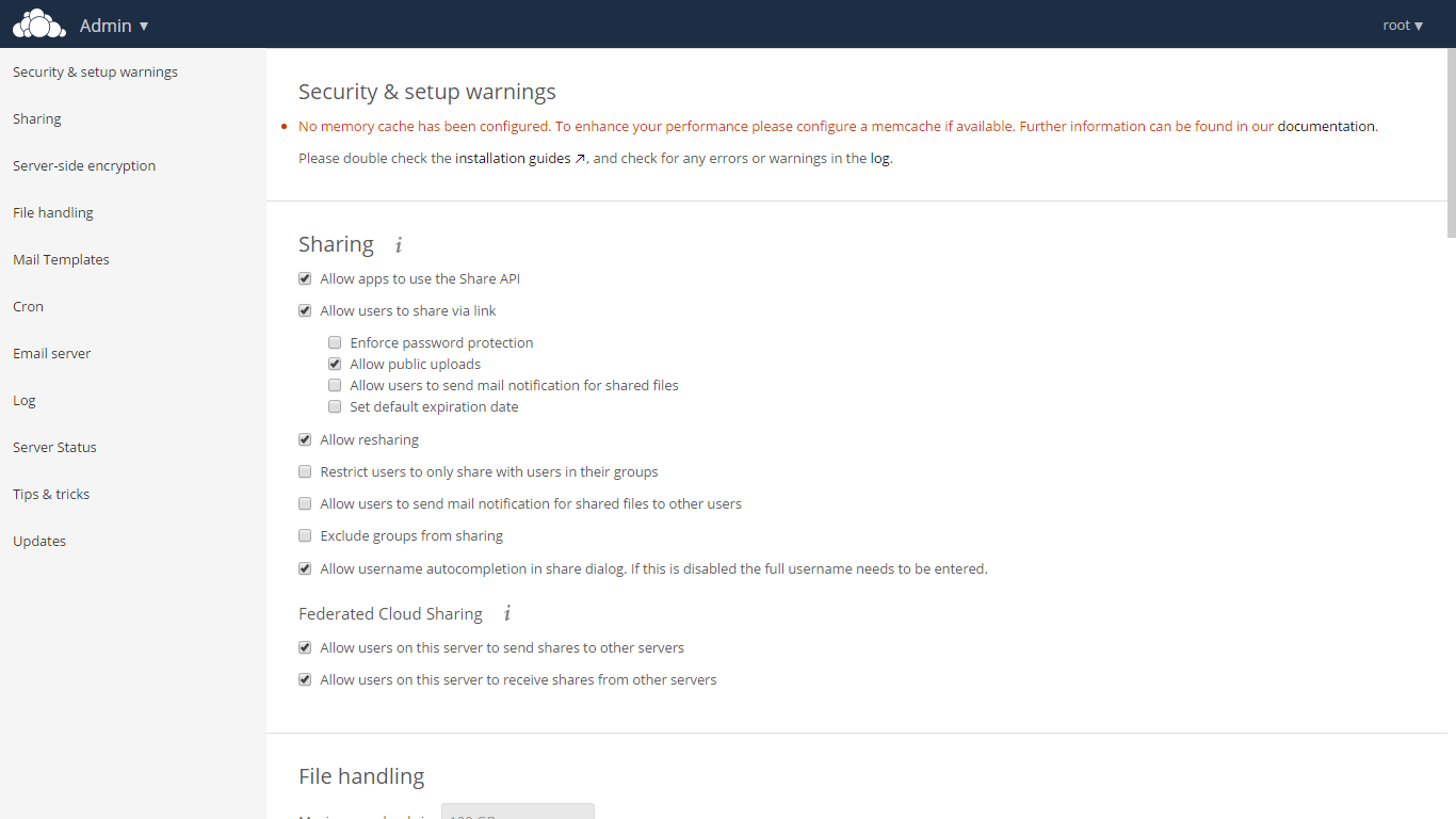

I only have 'Admin' on a drop down on the right side and nothing anywhere about "external storage".  I'm assuming you are talking about the web gui not a desktop app or something?

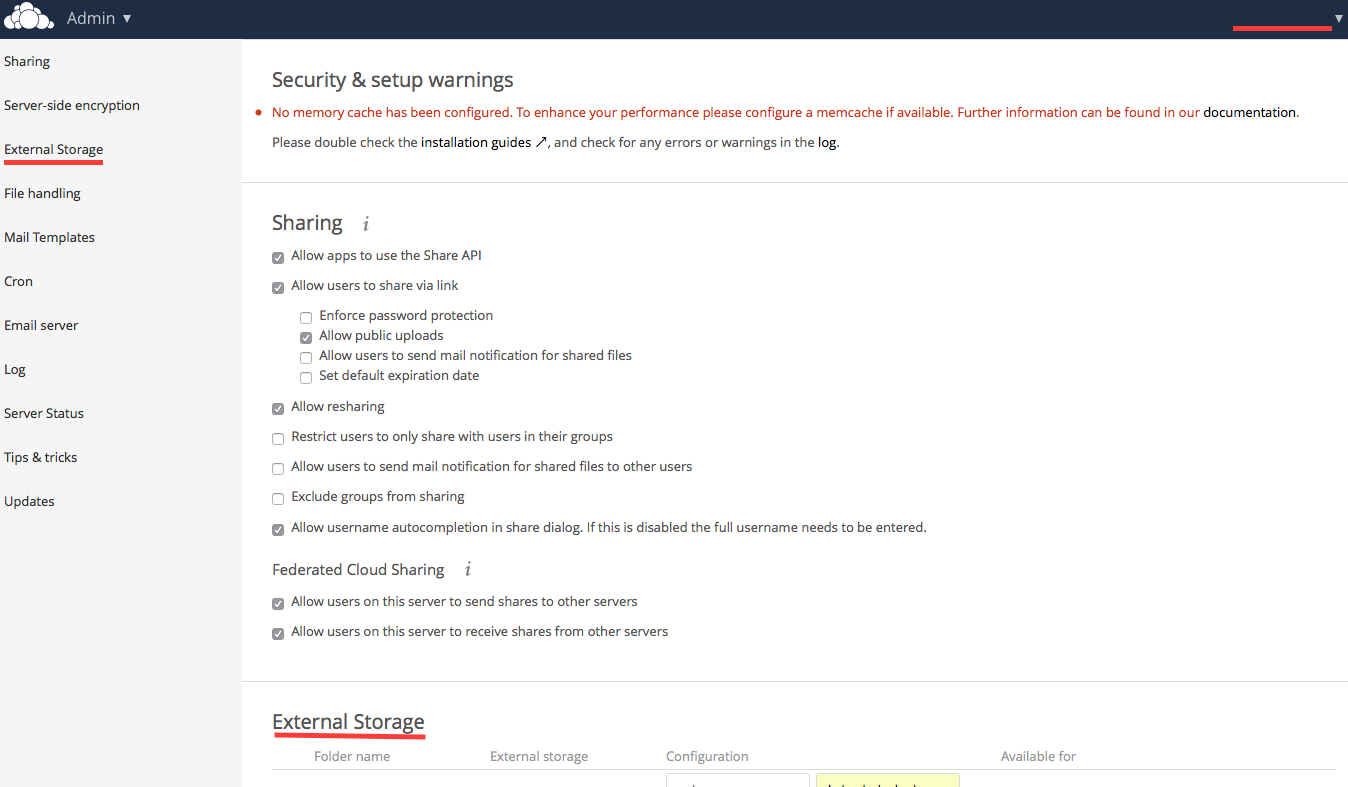

Hi. Sounds like you're almost there. Firstly Yes I am talking about the Web GUI and not some other interface. The only interface other than that I know of anyway is the iPhone app (which is nice by the way) but you can't do this level of config via the app.
Anyway ....
In the far top right hand corner will be the name of the admin user id you logged in as with an arrow next to it. You need to click this arrow to show the menu as show in the attached. Then Click "Admin" on this menu (highlighted in the image attached).
You will then be taken to a settings screen where one of the options on the left hand menu (or indeed if you just scroll down the page) is External Storage. See 2nd attached image (I have on this one also tried to highlight the areas I am talking about with red lines). And you can follow my guide as I posted.
My admin doesn't appear to have that as an option.  Strange.  I'm using the current docker install.
I believe you need to enable the 'External Storage support' app.  Go to the 'Not Enabled' apps and enable it.
That was it!  That was a tad hidden.
Thanks for the patience and help!  Now to make this useful and see if I like it.
I've tried:
[*]Waiting
Thanks!
Alright guys, I spent many more hours and tried to figure out what the heck was going on. So occ upgrade didn't work, somewhere in the thread there was mention of chowning and chmoding occ and that resulted in a bus error when trying to run occ upgrade.
So0o0o0o0ooooo.... here's what I did. I couldn't figure out how to revert the docker image, so I installed the correct version of owncloud in debian, manually updated that to 8.1.4, and then moved all the files /data and /config back after the update to unraid. Booted. and it worked.

If I understand the issue correctly you CAN access exisiting folders .....
I access my entire Array full of exisiting files through ownCloud by just adding the relevant folder as "External Storage" under the admin user section.
This assumes your unRAID share you want to appear and be available in ownCloud has SMB protocol enabled and you have an ownCloud user already setup to allocate access to this to:
1. Login as Admin.
2. On the user menu (top left hand corner) drop down the menu and click "Admin"
3. On the 3rd section down "external storage" give the folder a name (e.g. nas) and under the drop down menu select "SMB / CIFS".
4. After the new line appears fill in the appropriate details as requested (e.g. Host = just the dns name of your box, Userid and Password = self explanatory if you have security enabled, Share = share name in unRAID, Remote Subfolder = blank, Available For = name of the user (yourself I guess) that you setup who you want to have access to this unRAID share).
Boom Done. You'll get a green dot next to the Folder Name when it is setup correctly. This is the little test ownCloud does to ensure it can access the "External Storage".
It is also worth noting that while it is technically external given that you are accessing it over a "share" given everything is on the same box the speed is lightening as it is local really.
Now log out of admin. Log into the user you have just given access to and now you can see your share as if it was another folder and you can interact with your files at will.
Please note - be careful when doing this - especially if you share the root of your array. You are technically opening up your entire array to outside access (if enabled) and if someone gets access to your user id and or password and or a vulnerability becomes exploited in ownCloud which allows someone else to maliciously log on then someone can access all your data and do with it as they see fit.
I did the same by using Local instead of SMB/CIFS.  However, I had to first create a mountpoint (/UNRAID --> /mnt/user) in the owncloud config.
Honestly, I don't know if there is any advantage to doing it this way...just the way I did it as I learn as I go.  :)
