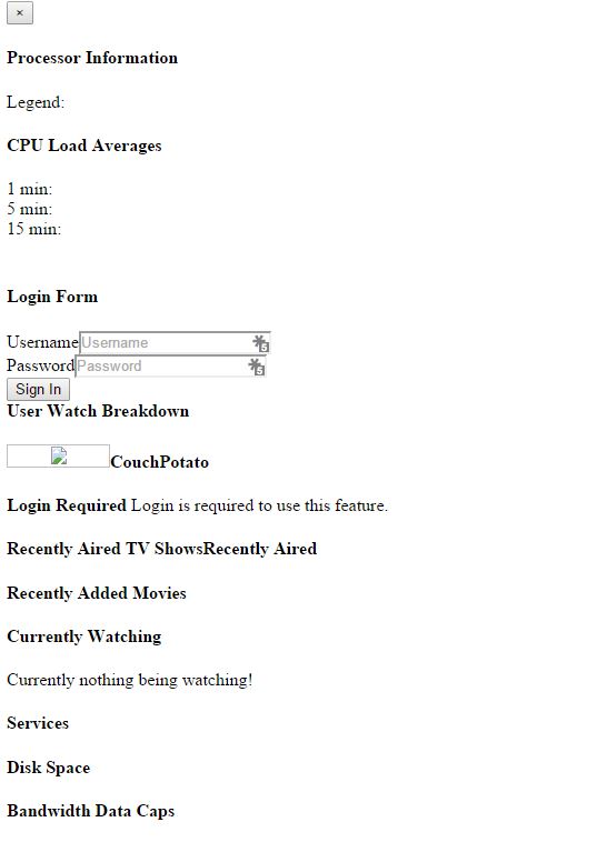

I'm having some issues getting Upstatsboard running behind the reverse proxy properly.  I had Upstatsboard running as a docker for a long time with no issues, so I know my basic config is good.
When I put it behind the reverse proxy so I can access it via https://mydomain.com/status it sort of works, but all of the formatting and graphics look like they're getting stripped out.
For the most part, I'm using a stripped down version of the example config of reverse-proxy that was posted at the top of the thread and I haven't touched my Upstatsboard config.  The ssl config seems to be fine too, I don't get any complaints from Chrome about the certificates or anything.

Try
                ProxyPass http://192.168.1.7:8024/status
                ProxyPassReverse http://192.168.1.7:8024/status
instead of
in the proxy config.

No luck.  Then I get
Cannot GET /status

What do you have in the config.js for UpStatsBoard
	"webRoot": 				"/status",
It was blank, but I tried "/status" and now get
Cannot GET /
Cannot GET /
ok.
If
is config.js
than proxy-config needs to be
If
	"webRoot": 				"/",
is config.js
Maybe put it back the way you had it and try a good ol clear cache/cookies?
Nevermind, got it.  When I changed webroot to "/status" I didn't have Proxypass in the proxy-config.conf set up with that.  It's all working now, thanks!
